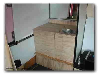

I guess I should show what I did instead, although this wouldn't work for most folks...(or at least for Mama)
i91 i101
It's a loo *and* a countertop.

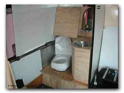

OK, I've been told by email that my photos don't make any sense, so I'll elaborate. The first post shows what I was planning to cover up the hole with after all the latrine, tank & SS surround stuff was removed.
I then changed my mind and decided to place the RV toilet base IN the hole left by the original chute, and as the hole opens to the engine compartment below, I placed the black tank below that in the engine room, just foreward of the AC compressor. So the toilet's base is *below* that raised wood floor/shelf, with the tank directly below that in the engineroom.
The sink is roughly where the original bus sink was, but it's larger, and it is seperately plumbed into the grey tank.
The countertop conceals the entire toilet when down, and reveals it when up. It's hinged in two places, with a gas strut which smoothly lifts it up. (just another 'lid' for mama to gripe about ;) So with all this, you don't waste floorspace with a 5 sqft throne area.
I'm *really* trying to use every square foot do to multiple tasks. After all, you can't use the toilet and brush yo teeth at the same time!
Wait till you see the other nutty ideas I have planned.
Posted on Friday, February 11, 2005 - 5:31 am:
sooooo....is the sewer hook-up on the drivers side ?
Posted on Friday, February 11, 2005 - 4:53 pm:
It's below the tank, which will be hosed underneath to drivers side. This arrangement is a prototype - I'm not sure how well it will work in practice. I don't expect that my abilities to imagine a workable solution will in any way be matched by a finished workable solution in reality! :-)
