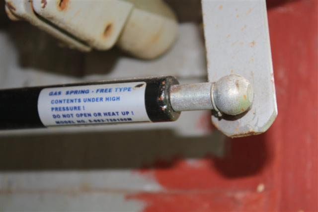

Dirk De Bakker (Kelvin12)
Username: Kelvin12
Post Number: 40
Registered: 1-2010
Posted From: 58.6.47.25
Posted on Saturday, January 28, 2012 - 10:27 pm:
Made the break between storms. Photo 009 is the style to avoid. The plastic cup is very easily popped off the ball and the hatch comes down suddenly, (experience here and it bloody hurts). One ram by itself is not enough to hold the hatch in the raised position. There are 2 rams per hatch making them really very easy to raise with just a light hand push. Sorry for the messy basement, still a work in progress.
OK photos don't number as I expected. First one is the type to avoid, plastic cup version.

Username: Gusc
Post Number: 1450
Registered: 11-2005
Posted From: 173.202.20.221
Posted on Saturday, January 28, 2012 - 11:39 pm:
Dirk,
Thanks. Interesting type of pantograph hinge, especially the hookup to the torsion bar. Much simpler than the GM type.
Now all I have to do is figure out how to adapt this to the GM hinge but your photos give me a whole new outlook on the layout.
Username: Kelvin12
Post Number: 42
Registered: 1-2010
Posted From: 124.168.152.84
Posted on Sunday, January 29, 2012 - 9:43 pm:
I don't think the bolted flange thing on the cross shaft is necessary, all the horizontal cross shaft is is an axle and the bent arms could just as easily be welded to the cross shaft. The curve in the vertical lift arms is only to clear body as they go up, guess you can see that. On the lower corner there is a short adjustable link from the door to the sub floor frame work so as the door can be kept in the vertical plain as it raises. Kind of like the secondary arm on pantograph windscreen wipers. More than happy to send anyone more photos if they like or other details. These doors were the main thing that attracted me to this bus, plenty of room to walk around without skirting around opened hinge up doors.
Dirk

Username: Gusc
Post Number: 1452
Registered: 11-2005
Posted From: 173.202.27.123
Posted on Tuesday, January 31, 2012 - 12:16 am:
Dirk,
So now you're saying the curved hinge arm is not attached to a torsion bar? I don't see how the torsion bar connected, or is there no torsion bar? I'm confused.
One good thing about the GM setup is there is a spring latch on the hinge to hold the door open.
Username: Kelvin12
Post Number: 43
Registered: 1-2010
Posted on Tuesday, January 31, 2012 - 10:05 pm:
G'Day Gus,
The curved arms are flange bolted to the horizontal shaft, but the horizontal shaft is not a torsion bar, well not as I would know as a torsion bar. The horizontal bar / shaft is merely an axle that partly rotates as the bin doors are raised / lowered. All the weight or lifting and holding the doors up is carried out by the gas rams only. The horizontal shaft is bushed at either end by hard nylon inserts either end. One end of the shaft has a stubby short shaft that fits inside the nylon bush and this in turn has a plate which is bolted to the forward end or the rear of the basement wall, as the case may be, the other end of the horizontal shaft has an adjustable (heavy bolt and washers) arrangement that also fits inside the nylon bush of the horizontal shaft on the other end and in turn bolts to the basement frame. The adjustable bit is to allow adjustment of the bin door fore and aft. There are slotted mountings on the actual bin door that allows for misalignment or up and down adjustment of the door. Hope my explanations are clear or if you want some more photos, ask away. I can always email them to you if you want rather than jamb up this forum.

Username: Gusc
Post Number: 1453
Registered: 11-2005
Posted From: 173.202.18.10
Posted on Wednesday, February 01, 2012 - 12:08 am:
Dirk,
Thanks, that is a good explanation, no need for photos. In the other photos the axles look just like GM torsion bars which are in approximately the same relative location but snug up against the ceiling. Unfortunately they tend to break!!
I think I can modify them to work just like yours by welding on strut attaching tabs like yours.
