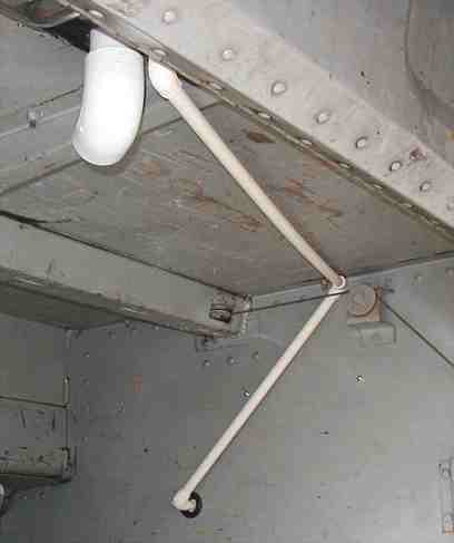

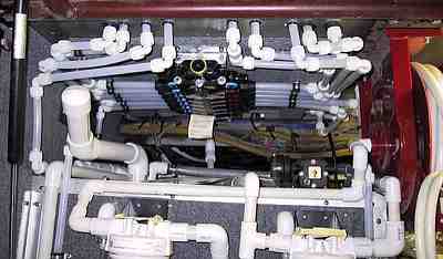

Sometimes I just *know* I'm forgetting something and if you would be so kind to look at this and tell me of anything I've forgotten before I glue it all up. I was planning to use PEX originally but couldn't find the stuff locally and was more comfortable being able to run to Homer's place every other day...
- 1/2" CPVC for all supply hot & cold (hope that's big enough) - The Nibco's are for regular use, the plastic valves rarely if ever - The tree is on the 'north' wall of the 'south' bay. (Front wall of bay 3) - Accum. will be in the pump output line What have I forgotten? I know this is kindergaten for you folks, but I'm getting a heat stroke from TX in August. Many thanks, Chuck Other WIP...

bill moldenhauer (12.74.15.205)
Rating: N/A Votes: 0 (Vote!) | | Posted on Saturday, August 21, 2004 - 10:09 pm: | |
What about the bathroom sink and shower I ran seperate line to each to be able to shut off one at a time in case Of a leak I have an aqua hot and ran a seperate manifold for hot and cold |
ChuckMC9 (Chucks) (66.167.95.178)
Rating: N/A Votes: 0 (Vote!) | | Posted on Saturday, August 21, 2004 - 10:27 pm: | |
The one labeled 'loo' goes to bathroom, where those fixtures split off there. Wasn't clear, thanks! |
TWO DOGS (4.227.114.218)
Rating: N/A Votes: 0 (Vote!) | | Posted on Saturday, August 21, 2004 - 10:49 pm: | |
excent choice on cpvc...excelent on hot AND cold...it is more burst proof in freezing weather...1/2" is what I used....works fine plenty for shower,haven't had anybody flush while I was in the shower,but imagine that would be as painful as always..... |
Rating: N/A Votes: 0 (Vote!) | | Posted on Saturday, August 21, 2004 - 10:51 pm: | |
don't forget to put that purple stuff on before you glue it....lots of people don't know why it's purple |
Rating: N/A Votes: 0 (Vote!) | | Posted on Saturday, August 21, 2004 - 10:56 pm: | |
maybe I'm looking at it wrong...it's in the bay...why is everything pointing DOWN |
Bob (Bobb) (216.232.250.26)
Rating: N/A Votes: 0 (Vote!) | | Posted on Saturday, August 21, 2004 - 11:03 pm: | |
I agree with TD.. why is everything pointing down. While the risk of freezing is probably the furthest thing from your heat exhausted mind right now, a really good system would be built so everything will drain to the lowest point. Of course you would have the drain valve located at this point. Further, a point at the top of the system to apply some air pressure to blow the lines out would be good too. Nothing like have a pipe burst due to freezing. (incidentially its not the water that bursts the pipe, but the air pressure of a trapped bubble of air in the pipe). They always burst at the most inaccessible places. |
Rating: N/A Votes: 0 (Vote!) | | Posted on Saturday, August 21, 2004 - 11:48 pm: | |
Re: pointing down - now *that's* the kind of bugaboo that the plumbing novice like me would never have known and I thought I'd read up pretty well. No reason except that it fit nicely into that space and seemed like things could be conveniently routed from there. Bob, you're very correct, Sir. No thoughts of freezing pipes in this weather but I will NOW! So basically, I could rotate the whole thing 90¡ CCW, and turn the intake around to point westward. (left toward the door/drivers side) Many thanks guys, you're Swell! |

James Maxwell (Jmaxwell) (66.81.40.213)
Rating: N/A Votes: 0 (Vote!) | | Posted on Sunday, August 22, 2004 - 12:15 am: | |
Chuck: Just one further tip. Use a minimum of 18" of flexible into and out of the pump; likewise at the accumulator. You will be amazed at how effective it is in eliminating vibration noises in the plumbing system. Does that sewer run have a rise in the middle of it or is that just a photo illusion? |
Rating: N/A Votes: 0 (Vote!) | | Posted on Sunday, August 22, 2004 - 1:36 am: | |
Ahh, more good info, James. In the pics, nothing is attached, supported or glued yet, so it's all sloppy-fit. Those loops around the pipes are bent coat-hangers just temporarily holding it all in place! Thanks for being there! |
FAST FRED (4.245.209.244)
Rating: N/A Votes: 0 (Vote!) | | Posted on Sunday, August 22, 2004 - 5:18 am: | |
1/2 is slow on big users like washmachines, and without a higher pressure pump than is RV common , even showers can be slower than "home 'style. 5/8 or 3/4 (best ) will accept pumps that turn on at 15psi and off at 30. The smaller 1/2 inch tubing will need a 30psi on and 50 off to deliver the goods. The difference is only a bit of extra battery drain ,more noise while running and higher priced pump , not a problem for the patient. FAST FRED |
TWO DOGS (4.227.119.7)
Rating: N/A Votes: 0 (Vote!) | | Posted on Sunday, August 22, 2004 - 7:39 am: | |
yeah ...rotate 90 degres ..or 100...I ran mine along the roof ,1" off the ceiling ,straped it to ceiling with plastic plumbers tape,then got foam insulation & put it around everything after it was all done...does look like you need more slope on the 3" line coming out of the tank...& mabe some braceing on it too.. |
Rating: N/A Votes: 0 (Vote!) | | Posted on Sunday, August 22, 2004 - 7:40 am: | |
maybe even rotate 180 degrees |

James Maxwell (Jmaxwell) (66.81.208.146)
Rating: N/A Votes: 0 (Vote!) | | Posted on Sunday, August 22, 2004 - 10:00 am: | |
FF: Respectfully disagree. A lot of water stands in 5/8 or 3/4, which translates to a lot of waste when waiting on Hot water. For hot water lines I use 3/8" copper but I see nothing wrong with CPVC either. Sureflow and FloJet both make 60 psi pumps that use no more power than their previous 40# models and are quieter. I also see no problem with using the 40# Whisper King or similar. My shower head outlet delivers nearly 5gpm free flow after approx. 14' of run w/8 90 degree bends to the mixer valve on the hot side (that was an actual test and not from a chart); more than enough considering I have a 2.5 gpm water saver head, figured at 40#. I just don't see the need for 5/8 or 3/4 supply side plumbing in an RV with the exception of a header or manifold. I also have a Splendide that performs just fine with 1/2 cold and 3/8 hot, with branch lines about 2' ahead of the shower mixing valve. Unless someone plans on permanent umbilical cords in a park, conservation should be of prime concern in an RV and 3/4" supply pipe has the capacity to drain even the largest water tank in a matter of minutes. Were talking about very short runs and fairly compact distribution systems in RV's and therefore pressure drop in distribution lines is minimal. Also, no practical purpose is accomplished in installing large lines and then putting in flow restrictors to conserve; only thing that accomplishes is wasting your money on "show and tell" crap, and in the case of a shower, freezing your ass off waiting on the hot water! |

Airless in Mississippi (68.243.255.30)
Rating: N/A Votes: 0 (Vote!) | | Posted on Sunday, August 22, 2004 - 10:38 pm: | |
Is the pump going to be ABOVE the manifold? Should the pipe for it be pointing down? To the hot water heater but what about from the hot water heater? |
Rating: N/A Votes: 0 (Vote!) | | Posted on Sunday, August 22, 2004 - 10:51 pm: | |
Airless, questions 1 & 2 - I dunno - I hadn't thought so, but now that I think about it, it seems like it should, if it's that important for all water to drain out for winter prep. Hmm. Mo thought needed on the pump. Question 3 - All this is cold only. HWH output will be a whole 'nother task. |

Rating: N/A Votes: 0 (Vote!) | | Posted on Monday, August 23, 2004 - 7:37 am: | |
yep, he's right...the one from the pump should be pointing down..and the aux...can be right after the ball valve on inlet... |

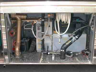

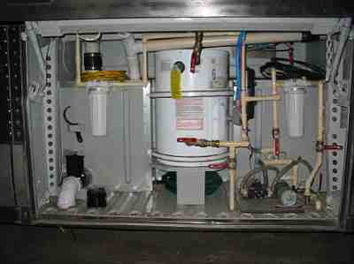

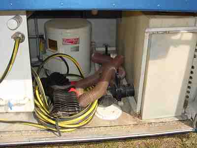

Other examples from around the web... I would love to see more so if anyone has a great example, post it!
Can't tell much from this one
Or this one
Or this one
Or this one
This one is almost understandable
Nice. This is the idea, but that's a *lot* o'valves?!
Sean's e x t r e m e system
And of course, hi-dollar |

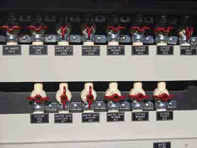

Lots of valves is about as usefull as a huge dashbored of gages monitoring Differential inner & outer seals temps. AS you will (hopefully) wish to use your coach in freezing weather at times. many folks just use OTS RV winterizing valves at the HW heater. This secures the HW circuit , and saves 40 gal of antifreez every cool snap. KISS WORKS! FAST FRED |
ChuckMC9 (Chucks) (66.167.142.82)
Rating: N/A Votes: 0 (Vote!) | | Posted on Monday, August 23, 2004 - 6:54 pm: | |
Yup, and thanks for the reminder, Fred. In reviewing my notes I just came upon a truly innovative idea from you that GaryS. posted awhile back, but it means dealing with yet more pipes! Yeech! I'll appreciate it a lot later on. By Gary Stadler on Sunday, April 25, 2004 - 11:07 am: "If you're going to use a standard "tank style" RV water heater, think about using Fast Fred's idea of a diverter valve at remotely located sinks, etc that lets hot water go back to the cold tank via a separate hose. You just turn it on until the hot water arrives, then close it and do your thing. No expensive "on demand" heaters, you get hot water almost immediately without wasting a drop, simple." And, you don't full up the grey tank more than necessary! |

I put a low cost ball valve in each line to each fixture and to the dishwasher. These valves do not restrict watter flow. The valves are all accessible from the luggage bays. I did this so I could easily isolate parts of the system in case of a leak or other needed repair or to make modifications. If something breaks down while on the road at an inconvenient hour or where you don't have ready access to repair parts, this may make the difference between a small inconvenience or something major. Our water pump is installed adjacent to the fresh water tank on a mounting on the floor of the bay where the tank is. It is connected to the fresh water tank and to the plumbing by means of braided flexible hoses. Dave Dulmage (MC-8) |

I have a "quick fill" valve asssembly that I purchased at RV Surplus in Elkhart, Indiana. It has a valve that switches from "Local Supply" to "Fresh Water Tank" to allow filling the tank. There are three connections to this assesmbly, one input connection from the city water supply, one to the bus plumbing system and one to the bus fresh water tank. When the fill position is selected it simply delivers water to the tank through the fill inlet in the tank, much as a gravity fill arrangment would. If you happen to forget or get distracted (it happens to me) when filling the tank, the worst that will happen is water will run out the vent line. I have two fresh water tanks connected together and have installed a vent line on each them. These vent lines are each terminated in in a marine through-the-hull type vent which has a mesh screen. These vents are intended for venting permanent fuel tanks in boats but work well for this purpose. The ones I used are chrome plated brass. These are mounted on a bracket which is fastened on the ceiling of the bay where the fresh water tanks are. The vents are oriented in a horizontal position with the openings on the side of the vents facing downwards. The ones I have used are similar to the picture below. Dave Dulmage \image |
DaveD (142.46.199.30)
Rating: N/A Votes: 0 (Vote!) | | Posted on Wednesday, August 25, 2004 - 10:56 am: | |
Image {Fresh Water Tank Vent} |
Rating: N/A Votes: 0 (Vote!) | | Posted on Wednesday, August 25, 2004 - 10:57 am: | |
ChuckMC9 (Chucks) (66.167.142.39)
Rating: N/A Votes: 0 (Vote!) | | Posted on Wednesday, August 25, 2004 - 10:09 pm: | |
OH YEAH!
"take a tip from the millions of commercial RV manufacturers and do it as simple as can be done"
Sorry, John - had to roll my eyes at you after that one! Standby for tomorrow's photo of finished, glued product. Ya'll will be rolling yo eyes at me. Like that hasn't been going on this entire thread. ;) This, from winnebago's site |
Jim Ashworth (Jimnh) (172.136.128.100)
Rating: N/A Votes: 0 (Vote!) | | Posted on Thursday, August 26, 2004 - 8:57 am: | |
That just re-confirms why I don't have a plastic house-car. Sorry Chuck, but I don't have a manifold either. Just soldered hard copper laid out as would be found in a house. To each his own. One bit of advice, pressure test the entire system with air and see if the pressure stays at the test pressure for several days before adding water. Air leakage is a lot less messy than water leakage (LOL). Jim |
