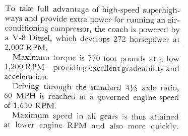

I have a 1961 4106 and notice in the book.(maintenance manual). I don't have a DD book. 565.5 CU.IN. 17:1 compression ratio and 235 brake hoursepower at governed speed (1650) But what is the horsepower and torque rating. Where can you find a DD book on an 8v71 and whats the going cost for then |
DonTX/KS (66.82.9.13)
Rating: N/A Votes: 0 (Vote!) | | Posted on Monday, December 01, 2003 - 8:29 pm: | |
The 4106 sales brochure had the best one I have ever seen, a chart with HP and torque plotted on a graph. VERY interesting chart it is, I hope someone can copy it for us, I loaned mine to a 4105 guy and he must have liked it too, been four years and he still has it. The torque falls off rapidly after about the 1150 rpm point as I recall, JL Vickers, I bet you have a copy of that brochure, right? |
Bob Baldwin (Bob4106) (66.56.100.54)
Rating: N/A Votes: 0 (Vote!) | | Posted on Monday, December 01, 2003 - 9:23 pm: | |
That would be nice because i just find it so interesting to see how much torque that some of the diesel motor have.(stump puller) And wanted to know since so many people have turn up their motors and run at a different rpm now that what the book saids. |

According to the PD-4106 specfications booklet that I just happend to find it states and I quote! Engine 8V/71 Displacement (cu.in.)567.4 Bore and Stroke 41/4" X 5" Compression Ratio 17:1 60cu. mm.injectors (std) B.H.P.@ 1650 rpm 235 Torque (max.ft. lbs. at 1200 rpm) 770 272 hp at 2000 rpm. 4-1/8 axle ratio 60 mph at 1650 rpm. 2100 rpm I would say around 75-80 mph? This is my guess. jlv |
DonTX/KS (66.82.9.36)
Rating: N/A Votes: 0 (Vote!) | | Posted on Tuesday, December 02, 2003 - 8:17 am: | |
Thanks JL. Wait til he gets the chart out though, the torque falls from 770 to about nothing at 2100 rpm. GM has you set the VS2 so that it cannot be shifted down above 1150 rpm, and will shift up at 1700 no matter what you do. |

Thats one thing I was looking for Don.I had a feeling it was around 1100 to 1200 rpm and shifting was around 1800 (now thats what I was thinking and going by motor sound don't have a tack) |

I looked at Mallie's chart (again), and read the specs. The chart shows the highest torque at 1600 rpms (800), but for the sake of comparison the specs only list what the torque is at 1200 rpms (770). So the highest torque IS at 1600 rpms. Also, at 2100 rpms the torque is 760, very close to what the torque is at 1200 rpms (770). So with your governor set at 2100 (full load) rpms, you are climbing the torque curve as the horsepower drops until you get below 1600, where it starts to drop again. So, the shift point shouldn't be lower than 1600 to maintain the best torque and horsepower when climbing a grade. I wish I could see a 92 horsepower/torque chart like this one-- the 92's have a wider torque range. |
DonTX/KS (66.82.9.43)
Rating: N/A Votes: 0 (Vote!) | | Posted on Friday, December 05, 2003 - 11:11 am: | |
Nope, just not so. I will prove it when the mail gets it here. Torque on a 4106 is definitely less at 1600 than at 1200, and the rating at 1200 is chosen because that is where it peaks. Like I said earlier several times, that does not apply to ALL diesels by a long shot, only to the 4106 detuned 8V71. The four strokes have a considerably different torque curve also. |
Geoff (Geoff) (66.238.120.161)
Rating: N/A Votes: 0 (Vote!) | | Posted on Friday, December 05, 2003 - 11:17 am: | |
Yes, I didn't notice that the chart was for the N65 injector, and the lower specs are at peak. You got me! |
DonTX/KS (66.82.9.39)
Rating: N/A Votes: 0 (Vote!) | | Posted on Friday, December 05, 2003 - 1:25 pm: | |
Yeah, I thought that was going on there. Want a shock? Somebody publish the torque for a 3406 Cat and then be prepared to cry if you don't have one in the bus. |
