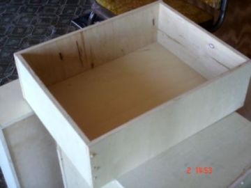

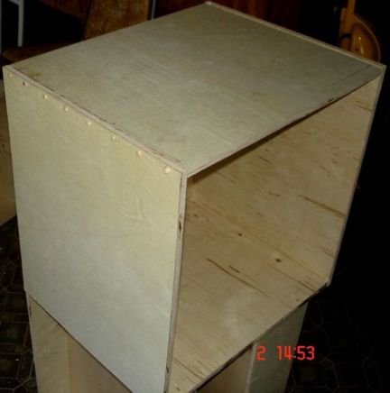

Pictures of a couple of the correct size boxes.
I used 1/4" dowels along the front sides that I'll trim off with an orbital sander. I also used Gorilla brand exterior wood glue, (not the normal Gorilla glue you are use to). On the back sides I used glue and 1 1/4" 16 gauge brad nails from my air nailer.
Yes, I have a dove tail jig I was going to use, but my bit is so dull it does more burning than cutting so I went with dowels as opposed to box or finger joints.
There is still a lot of glue joint surface,and in an experiment I made a small corner this way with 4 dowels then after sitting 24 hours I tried to pull it apart. 2 dowels broke, chunks of both the edge glued side came out and pieces of the surface side came apart. So far I'm very happy with this glue.

The drawers look nice and robust , but a length of 1/4 round glued into each corner would almost double the glue area at no cost.
Should the drawer get loose full of heavy stuff , it might help.
Sailors love overkill!

good idea Fred!
I hate when things come apart unexpectedly, and my wife is famous for stuffing 50 cubic feet worth of stuff into a 10 cubic foot space!
