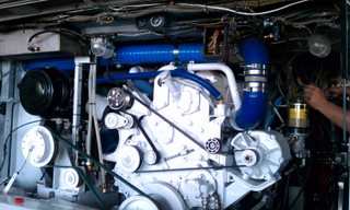

The radiator is in and secured! The engine is painted, the new hoses are cut and installed and some clamps are on and tight. Found that a couple of my clamps were pretty rusted and won't loosen let alone tighten so I will be replacing those!
While painting the copper water pipes to match the engine, the damn love bugs swarmed and got the large one going to the upper radiator connection so I had to strip it down and re-paint it. That is what I am waiting on now (paint drying) so I can install it and then I think I will be ready to fill it back up with new anti freeze.
Man have you ever sat there and watch paint dry? Very boring! :-)
If all goes as planned, and the weather holds out like it has, I should be ready to roll again by the weekend!
I know I took a lot longer than normal but I did save 500-750.00 big ones! That's a tank of fuel!

White believe that or not!
My friend who just did a 60 series upgrade painted his white and it kind of grew on me so I went home and after a couple days pondering over it, It was decided to, just do it! I figured it can always be done pink or purple the next go around! :-)
Here you can see the two motors, his big 14 litre and my little 8v92

John thanks and although it sounded easy and for the most part it was, some of the bolts that hold the fan shroud in place and TWO very stubborn bolts that brace the radiator at the top were VERY hard to get started. The shroud bolts were easy to screw in but very hard to reach unless of course your part contortionist, and the two bolts at the top really did claim some skin from both Susan and I due to not having but about 2 inches of room to work, if that! Both if us have matching scars/scabs on the back of our right hand where we both were struggling to get ONE of the two bolts in! Finally after some thought we figured out an easier way!
Also pictures of both show freshly painted and clean motors but both have their "issues" where the pics don't show everything! His was painted OUT of the coach and mine was IN the coach which was a LOT harder. His went thru the hell of installation where mine, well, was just plain hard to reach without painting something you really didn't want painted! Much-O touch up has been done and still to do!
Maybe I can talk Susan into letting me post pictures of our hands!

Put 10 gallon of anti-freeze in along with 5 gallon of distilled water. Actually put in 2.5 gallon and then 2 gallon of water, then 2.5 gallon and then 2 gallon of water until it was full.
I ran it tonight checking for leaks but it only got up to 176 degrees and then dark and hungry so I will run it again tomorrow when it hopefully gets hotter outside. There were NO leaks and so far that is a good thing! :-)
