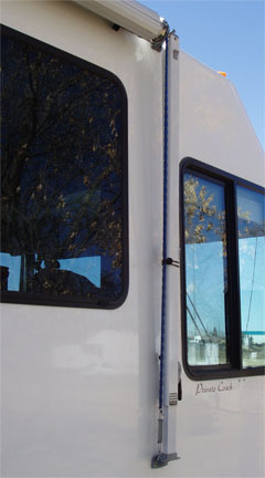

Yes this has happened to me.....the fix is a locking device that prevents the awning from unrolling. Mine is a large stainless steel Hose clamp fastened to the roller at the front next to the unlock lever. The Hose clamp has a clevis pin fastened to it in which I hook a rubber coated chain with an S hook. This chain is in turn fastened to the arm mount (in the hole) in which the awning arm is resting. The lower S hook is cushioned by a gate spring.

Daffycanuck wrote: Mine is a large stainless steel Hose clamp fastened to the roller at the front next to the unlock lever. The Hose clamp has a clevis pin fastened to it in which I hook a rubber coated chain with an S hook. This chain is in turn fastened to the arm mount (in the hole) in which the awning arm is resting. The lower S hook is cushioned by a gate spring. I looked at the pics (and thank you very much for that), but I'm having difficulty understanding how this prevents the awning from unfurling? Wouldn't you need something that ties the top part of the awning (rolled up) directly to the bus? Maybe this does that, but sorry I don't see it. Thanks in advance. |

Wagwar, the hose clamp is fastened to the roller, then the chain is hooked into the clevis pin and then the bottom mount. It prevents the awning from unravelling... |
