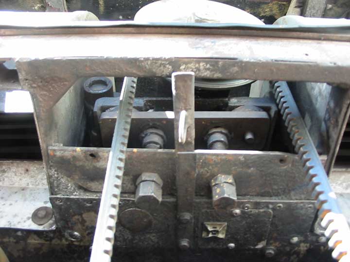

I have a Manuel Adjustment on my 66 5a 2 bolts screw up pushing the pulley up with a lock nut on each side. Once I used a good belt from a truck source and stretched bad 5 years ago I got one from MCI (Its a special belt Manufacturer will not say what its made out of) tightened and still going strong the 2 blots are the only adjustment!

Here you can see the Bolts and nuts for adjustment
Here you can see the welded nuts that the adjustment blots go through
