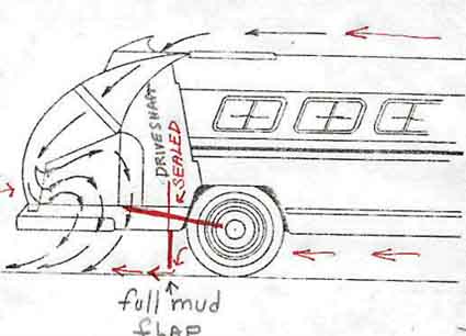

You said yours is similar to how a FLX works... Here's what I found on the FLX Owner's Group site...
FLX Cooling
From the site Flxible Owner's Group:
quote:
There is one popular bodge with which some owners report success. Since the belly pan is usually missing, and usually awkward to duplicate, some owners have elected to build an "air dam" - a full-width mudflap behind the rear wheels.This mudflap is mounted at the bottom of a full baffle designed to prevent airflow from floor to mudflap. Thus the rearward underbus airflow is directed to the sides, hopefully even aiding in the creation of a low-pressure area behind it, which will help the proper flow through the scoop, above-engine duct, and fan/shroud.

Nice picture Mac, congrats on the new bus! Our GM just sent the air staight out the back after pulling thru the rad.Now i am second guessing my memory and will pull what i can from the parts service book and see what is what. The one in Hershey will soon get i visit i think.
