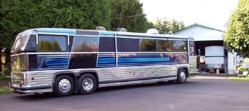

Iver (Mciv)
Username: Mciv
Post Number: 26
Registered: 11-2006
Posted From: 70.69.131.252
Posted on Tuesday, November 03, 2009 - 10:03 am:
My winter home for two....
Bus Shop
My problem solved.....
Iver.
David Dulmage (Daved)
Username: Daved
Post Number: 263
Registered: 12-2003
Posted From: 142.46.199.30
Posted on Tuesday, November 03, 2009 - 5:49 pm:
Iver,
That's one sharp looking coach!
Dave

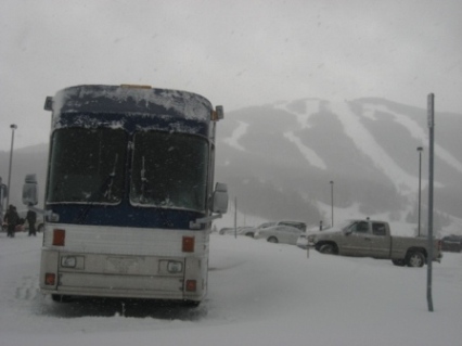

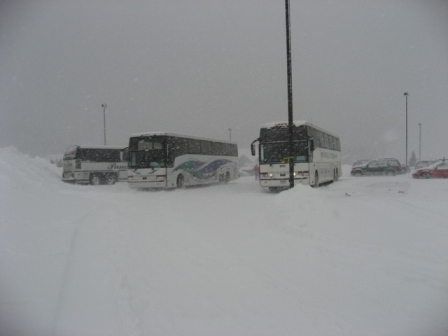

Cindy and John (Cindyandjohn)
Username: Cindyandjohn
Post Number: 101
Registered: 1-2007
Posted From: 75.97.182.140
Posted on Tuesday, November 03, 2009 - 11:42 pm:
Better yet - get out there and use it!
Killington VT...
The poor guys in the tour buses had to drive passangers home. We stayed an extra day till the roads were cleared.
John
