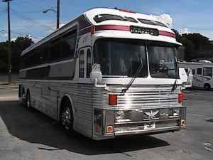

Here one of the 4905's...
1975 GMC 4905a
Here's the Eagle...
1965 Eagle
Both are partial conversions... The 4905 pictured has 3 rooftop airs... The Eagle has none. None will have a generator (I'm reusing the one from my burned 4905)... All seem to be in excellent shape for their age.
I'm still waiting on additional pictures for some of the known trouble spots... The Eagle is actually a little less pricewise than the 4905 above.
I'm still in the air on which one to purchase though... It's a good fit no matter which I choose... However, with the 4905's, as was said... I have a parts bus which I can pull parts off of for as long as I have it... I also have _ALL_ the manuals for the 4905's... And NONE for the Eagle... But that can be fixed, I can obtain the manuals... Not really THAT big a deal...
So... Assuming the Eagle really is in as good of shape as it appears to be, and likewise for the 4905's... I'm still leaning towards the Eagle, but will still likely end up with a 4905... As I said, I liked mine... It handled nice, it rode nice and it was comfortable to drive.
I've never driven an Eagle... So I have no basis for comparison between the two on that aspect...
I can say that the additional interior height in the Eagle sure seems nice (I'm 6'0" tall)... At least, from what I've read and heard, the Eagle has more headroom... Am I mistaken? But, at the same time... I really like the massive bays for storage that are on the 4905... Storage is one thing that is always in short supply on a rolling or floating home...
So... Imagine yourselves with this decision... No preconceptions... What you see is what ya get and they're of equal price (within $500 of one another, might as well be equal)... Which would YOU get? Why?
-Mac

Rust tho.... Man, that's a tough one! I would check in the electrical
panel aside the driver's seat, and see what the rust looks like.
Check the wheel wells also, up and around the compartments,
and under the windows, at the floor...

Yeah, I'm having them send me pics of those areas... I'm getting a LOT more pics from the Eagle's current owner because of the rust issues known to be present on them... He SAYS the rust that's there is "just surface rust"... But I don't know... I'm waiting on the pics of the electrical boxes, wheel wells, etc... On all the buses I'm considering.

Pictures of rust just won't hack it. You have to take an ice pick
with you, and poke into the rust areas, just as you would
looking for rot in a wood-frame house .. What might look like
surface rust, could be clean through.
I got 9 mpg with the 01 Eagle I drove. With the gov adjusted,
it would cruise at 86 mph. The stability in the wind, and on icy
roads, was something any bus driver should experience at least
once in their life.
Air bags give a smooth ride, but torsion bar suspension can't
be beat. And it's a lot less air problems to have to deal with!
I had the "johnson brake" on the 01 I drove, and having a skinner
valve freeze mid-trip was less of a problem, since that hand brake
would do well, once the bus was almost stopped using the trans.
I would hate to talk you into a rust-bucket, so please beware?
