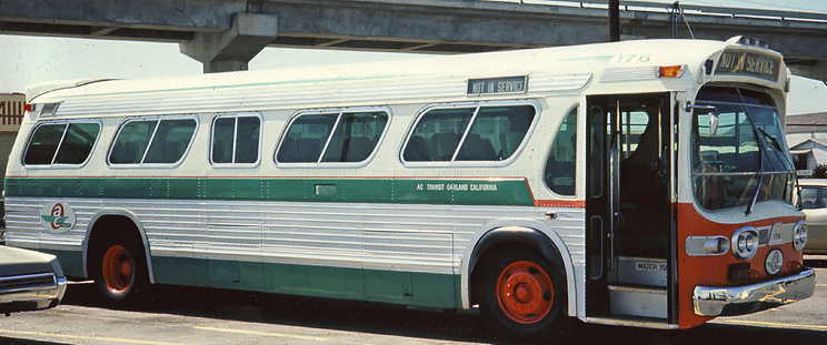

What's the full VIN on your coach? SDM4501-XXXX? Could it be this one:
ACTSDM176
FWIW & HTH. . .

Posted on Saturday, October 10, 2009 - 9:29 pm:
RJ -
Nice Work!!! That's our bus...Nellie!!!!!! Good Ol' # 175!!!
The only modification that was made to her at somepoint was the removal of the aluminum above the windows, and it was replaced with standee windows. But that's her!!! All the way down to the flag holders mounted on either side of the windshield at the very top!!! Also, she no longer wears A/C's colors. She still has the same color patterning, but the orange and green are now blue, and the wheels are painted white. Where the paint is peeling slightly on the nose you can still see the original orange color though.
As soon as I can get out to the storage facility, I will check for the tranny model #. As far as the max gear speed goes, I'm not positive, as the speedo doesn't work, but I think it is close to the following: 1st 10-12 mph, 2nd 22-25 mph, 3rd 45-50 mph, 4th 72 mph.
I will also try to get some current pictures of her to post here as well.
Her full vin # is SDM 4501-070.
