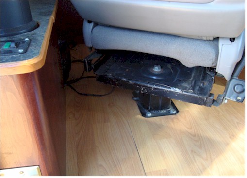

I want to weld in a piece of 3/8 steel plate just under ¾ plywood floor. Then I can drill thru the plywood and steel then tap steel to mount copilot seat and seat belts.
Can you tell me how far back from the stair well and out from the wall to the center the
Seat base?
We do not have the seat at this time
All Ideas Appreciated
Paul

If it were me I'd have the seat and seat base so you would know the hole spacing. I wouldn't want to go to all that work and the holes not be centered with the base, or the proper location of the seat. Install the plate then drill and tap later.

I agree with Paul, wait until you get your seat and pedastal before you drill and tap the holes. We did the same thing on our coach. We welded in 2 steel plates (one to attach the bolts in the front of the pedestal and one to attach the rear bolts). We ran the steel from the wall framing to the framing on the passenger side of then OEM "ramp" in the center of the bus.
All pedestals are not standardized. I have several that have different base dimemsions and bolt patterns. Are you attaching the seat belts to this steel plate or to the seat? Jack

Planed on putting a 3/8 steel plate large enough that the pedestal could be moved 4" to 6" forward, back, right or left. This would mean a plate under the floor 6" to 12" in each direction larger then the seat base. There will be precious cargo in that seat (ME) the wife will be driving!

Paul, make sure your seat belt anchor points are to the STRUCTURE of the bus, not just to the floor. Really, the seat base should be bolted to the same also. In a frontal collision, the G forces are extreme. A few years ago a charter driver of an MC-9 hit a trailer in the freeway that had fallen off. At night. He had his seat belt on, but seat, driver and all was ejected through the windshield. The old rusty bolts snapped and everything pulled right out of the floor. Anchor everything to the front structure for safety. Don't know if any law outlines how this applies to conversions. Common sense rules.

3/8 is over kill. 1/4 or 3/16 plate would be fine.
I mounted the copilot seat on a swivel base so I made sure that it could swivel facing the rear of the coach.
I mounted mine 24" O/C, back from the edge of the stair well and 20" O/C from the side. I have a narrow cabinet on the side for drink holder and maps etc.
