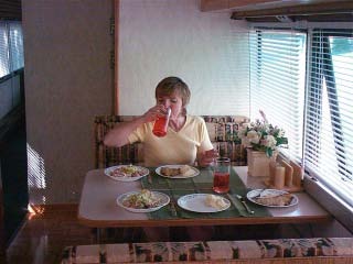

Posted on Tuesday, February 10, 2009 - 2:33 pm:
We bought our dinette from a large RV dealer, who had taken it out of a new motor home. It needed some improvements to its construction, but the upholstery was quite nice and it makes a very comfortable bed when needed.
Dinette
