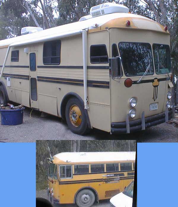

Posted on Tuesday, September 17, 2002 - 4:12 pm:
Here's a quickie before and after photo of where I curently am. I went for fewer windows and like it... just enough to see out of and not too much heat from the outside getting in. (The windshields are now the worst offender!) Like John, it's been sooo much fun doing the thinking, and especially having it turn out "right"!!
And as incentive for the obsessive like me, I bought the bus in May of this year!!!

DaveD (216.18.113.69)
Posted on Tuesday, September 17, 2002 - 8:23 pm:
Just shows what you can do if you are motivated. I've left the windows in my MC-8. I like the panoramic view. Unfortunately, most of my view on the road is through the windshield from the driver's seat. It would be nice to have someone else in the family who was licensed to drive this thing once in a while.
DaveD
John Biundo (Jbiundo) (67.112.121.112)
Posted on Tuesday, September 17, 2002 - 8:42 pm:
Hey Gary,
Looking good! Wish my progress were as rapid. Though I'm approaching a point where it'll look somewhere close to "done" from the outside (short of trim, paint, etc.). Actually, my biggest problem (honestly) is not letting my need for instant gratification overcome my planning! So many times I WANT to do the thing that will have a big visual impact -- but the danger is that I then "shortcut" the detailed planning that's really needed to do things "right".
But some "visual rewards" are shortly forthcoming. In fact, almost enough so that I'm considering investing some effort into putting up a little web site to "share" (OK, brag!) about my progress!
It's encouraging to see progress such as yours. Keep the journalism (photo and textual) coming!
