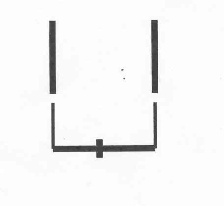

And lastly, you should install a "double receiver hitch" on the coach. What that means is you weld a piece of square tubing about 24 inches long to the bottom of the engine rails, insert a square tube one size smaller into the tubes, as shown below.
Double receiver hitch
As the tubing is bolted with a Grade 8 bolt on each side, it gives you the convenience of removing it to take your engine out with interference, if required, from a hitch assembly.
This configuration also is very strong as we were hit a year ago from the rear by a drunk driver going to fast and was trying to dodge to the left. He hit our car on the left side tailight, veered across the road and flipped. There was one little mark on the the back door of the coach, but the towbar was totaled a well as the car... Damage to the receiver hitch was a slight bend on the cross piece.
Just food for thought

Nice design Arnie - I see you used the offset hitch reciever -
