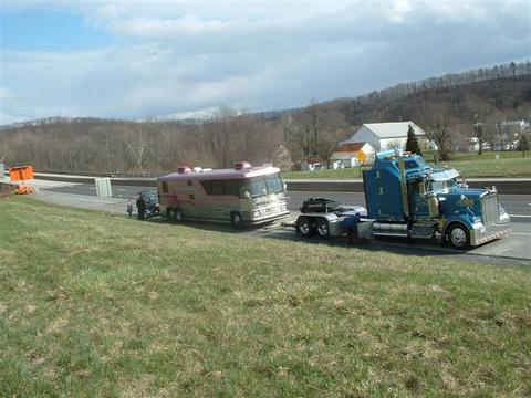

Posted on Wednesday, December 17, 2008 - 3:47 pm:
Hey, where's everybody's picture? C'mon guys, pictures are part of the fun.
Axle pulled - Wheel lift
4 speed manual trans
(Message edited by ednj on December 17, 2008)

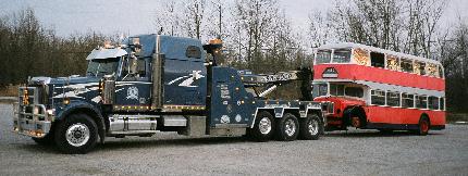

Tim (Timkar)
Username: Timkar
Post Number: 116
Posted From: 24.64.223.203
Posted on Wednesday, December 17, 2008 - 4:31 pm:
Axles were pulled and being disconnected from a tow in "Winterpeg" - March 05

As has been said many times before, a picture is worth a thousand words. Both Ed & Tim's coaches are being towed by a Class 8 tow truck with what's known as a "stinger", which you can just make out in Ed's second photo. The stinger picks the front of the coach up by the front axle. Perfectly fine way to tow for short/medium hauls, but for the really long haul, a Landoll trailer is preferred.
Main point is, however, that when you call for roadservice, make sure they understand that you need the Class 8 rig. Here's one instance where it's good to tell them "Greyhound bus" to get the correct image in the operator's mind! Otherwise, they might send out something like this:

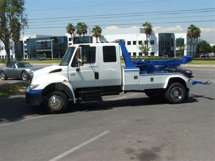

If you're towing a high vehicle, you have to have a "low tow".
low tow
If you lift one end, that end will be "overheight" and so the tow truck has to lift the axle (or frame tow point), then remove the wheels and finally drop the vehicle down so that it's highest point isn't above legal height.
the one towing my coach is a wheel lift, not by the axle on a independent.
Here's one for ya.

That guy in the picture above is risking buckling that MCI. Should have read the maintenance manual.

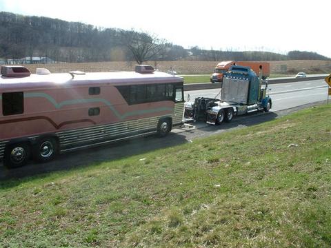

Here's one of my moves on a Landoll trailer. Fast and damage free every time.1948 Kenworth, ex NW Greyhound

Landoll is definitely the best way to go.
When my last two treasures where brought home, it was on Landolls. Quite the sight when you have two in tandem.
