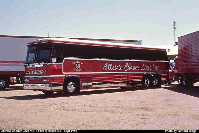

All of the lower exterior sides of your MCI are stainless steel. The sign or billboard area above the baggage bins is aluminum
The rub rails, too, are also aluminum. If you really want them to shine, you could do like this charter coach operator did:
Allstate 125
FWIW & HTH. . .
(Message edited by rjlong on December 05, 2008)

The shiny rub rails in the picture are polished stainless rub rail covers, attached to the aluminum rub rail with Sikaflex. When we had MC-9's we used a lot of them. Can be purchased from International Bus Parts. A nice touch. Can be used on Prevost too.
Mark Renner (Boomer)
Username: Boomer
Post Number: 127
Registered: 11-2006
Posted From: 75.208.49.188
Posted on Saturday, December 06, 2008 - 3:47 am:
Just looked at the date in the picture. They probably were polished aluminum. Don't think the stainless covers were around then, but they are now.

Actually, those "polished" rub rails on that Allstate MC-9 are chromed! Yes, chromed! So are the mirrors and the front breastplate.
I know, because the coach pictured was assigned to me, as I worked for Allstate when the photo was taken.
Another interesting bit of trivia about that particular coach - it was the first MC-9 off the production line!
Allstate had a fleet of 12 coaches, all as nice as this one, and all kept busy year-round. Sadly, John Mancebo, the owner, got cancer and quickly passed away, and the fleet was sold off.

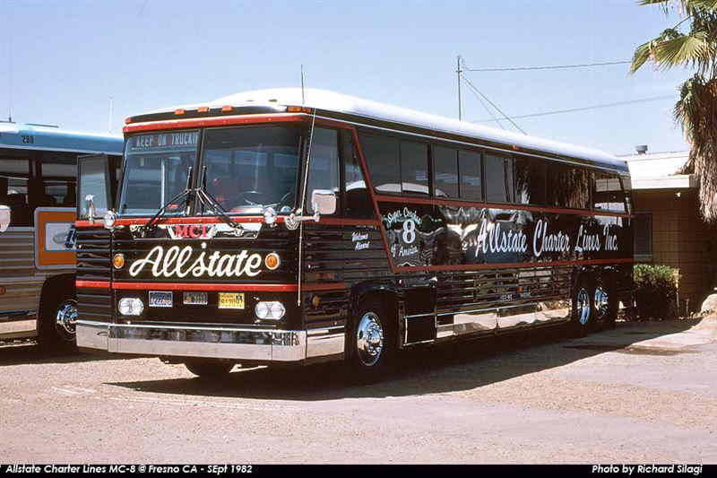

Here's another pic of one of the fleet, this one an MC-8, which was also the oldest coach at the time:
Allstate 121
FWIW & HTH. . .
PS: My thanks to Richard Silagi for the photos!

Are those spotlights on each side just below the windshield? They look like the spotlights we had on our ambulances many years ago. If so, how was the passenger side light controlled by the driver?
Username: Rjlong
Post Number: 1461
Posted From: 67.181.166.160
Posted on Sunday, December 07, 2008 - 9:15 pm:
Jack -
They were fixed, you couldn't move either side. More decorative than functional, as they were focused on the road about 150 feet in front of the coach.
-RJ
