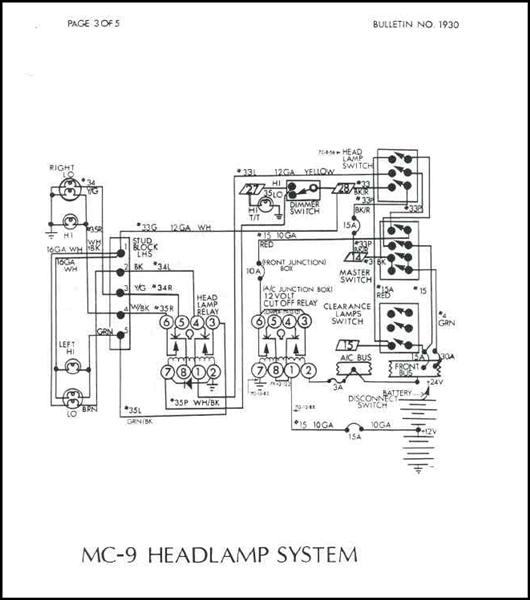

Wish someone with a MCI 5 schematic would post the headlamp circuit. All or most of the wiring and parts should be there with the exception of the balance lead and maybe a couple headlamp relays (cheap). They just need to be rearranged to use 12 Volt bulbs.

Sorry to say this, but if it took the guy 10 hours to do what you posted, with NO repairs, he's no electrician, and you got had.
Me and John go way back, but he made a mistake in his last post, my schematic, which is a simplification of MCI's drawing, WILL NOT BURN WATER OUT OF EITHER BATTERY, PERIOD!!!!! (Neither will MCI'S.)
BW !CORRECTLY! explained the current flow thru MCI's circuit in his reply to your first post on this subject.
What I suggest is to follow the wire from the bus hot thru the master, the dimmer switch in whatever position you choose, and the headlight(s) on that side. Note that the "ground" wires on that side are connected to the equalizing wire, which is connected to the negative terminal of the ungrounded battery. Now, follow the connection from the positive of the grounded battery, (which just happens to be the equalizer wire) thru the 24 Volt relay that is added, thru the headlight(s) on the other side, and to chassis ground. After a while, it will sink in that each battery runs the headlights on one side only, thus the current draw out of each battery is equal. And, if you want to get really picky, BW was and IS right, with the engine running and the lights on, no headlight current flows thru either battery, it ALL goes thru the headlights. If one burns out, the other stays lit, and still no unwanted current flow because of the equalizer wire.
In my comments on your previous post on this subject, please note the part reading "you can't run two 12V low/hi beam headlights in series on 24V and have them work properly, because they have only one ground for the two filaments." Obviously this is part of what your previous owner tried to do.
There are several of us here who can apply my drawing to your bus, and have 12V halogen bulbs operating properly, IN THREE HOURS!

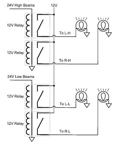

George, Don, Nellie & others -
I was doing some computer clean-up work on my picture files last night and came across this schematic for 12vdc headlamps on a 24vdc system. Would appreciate your comments.
12v lamps on 24v system
FWIW & HTH. . .

RJ's circuits look workable to me. My only concern would be with the consequences of having a relay fail. Since the two relays are wired in series, if either one fails, both lights go dark. It is not that much of a concern on the high beams, but could be on the low beams. It wouldn't be much fun to be twisting around some back roads at 10pm and suddenly have no lights. If going with that design I would use high quality relays and be absolutely sure of all wiring connections.

RJ,
It depends on how the 12V is derived. If it is from a 12-24V converter or a Vanner or a house bank that is 12V it will work. If the 12V source is a center tap from the batteries you have a unbalanced battery bank and much use can damage the batteries.
The converter or Vanner are maybe a little less reliable than following George's diagram in that if the converter or Vanner dies you are left without any headlights. If you have a lamp burn out there is no risk to the batteries from being unbalanced.
If you follow George's plan any one part failing is not going to leave you without any headlights. However with the center tapped system if you run for an extended period with a headlamp out you are unbalanced and can damage the batteries.
As they say, you pays your money and you takes your chances.

RJ,
I would echo Wec's comments on relays in series, and Don's on the source of the 12V supply.

Please read Nellie's prior post on "Headlight problems," and all of the replies carefully.
Please spend some time on the schematic that I provided, and realize that it has been viewed by everyone on the board, and nobody wants to change it. I put a lot of thought into that schematic to make it SIMPLE, COST-EFFECTIVE, and SAFE!
Please note all of the comments about "center tapping not being advisable," and explain how "Use your ... 12V house system to supply 12V to the headlight switch is not going to abuse the ungrounded battery in a 24V bus? (Nellie does NOT have a seperate 12V alternator to run her house batteries.)
Ignoring the cost of a Vanner, it does produce heat while operating, so must be installed in a dry ventilated area, and cables run to it from EACH of the four battery terminals, and a 12V supply cable run to the front. Then the headlight switch wire moved from the 24V hot to the 12V hot. Change the headlights, and the high beam indicator bulb, and drive off, right?
Back in the 18th century, a guy named Ohm firgured out that I=E/R. I is induced current measured in Amps, E is electromotive force measured in Volts, and R is the resistance measured in Ohms. Then a guy named Watt figured out that Watts, (the electrical unit of work) is amps times volts. W=AxV
My schematic requires two 24V single-pole relays, two automatic resetting circuit breakers, and some wire, period. If I had really had my act together, it could have been drawn needing only one circuit breaker, but oh well. The entire right side headlight wiring is done by moving the ground wire from the chassis to the equalizer wire. The rest of the wiring changes are done in the front junction box of an MCI.
Sorry to jump on a newbie, and just because I have over 600 more posts doesn't make me qualified, but. There is a whole lot of work put into that schematic to make it dependable, cost-effective, simple, AND WORK PROPERLY, which includes not abusing the un-grounded battery.
Please tell us what is going to happen when Nellie turns on her new headlights after following either of your suggestions. (I've given you the information to figure it out.)
IMNSHO, ten hours to figure out less than 15 individual wire runs, all of then color-coded and tagged, the longest run being less than 12 feet is way excessive.

I don't know where I got that schematic. As I said in my post, I was going thru some picture files on my computer and ran across it.
Now, if we really want to screw Nellie up, shall we post the schematic for how GMC used 12v headlamps on their 24v systems?? I think I may have one somewhere. . .

Great schematic, George! It's a decent way to rewire for
12vdc headlamps.
The one thing I've noted through the years I've lurked on these type
forums, is that the ability of the readers are very varied. While your
rewiring project may seem easy to you (along with many others),
there are probably an equal number of individuals that will feel
the undertaking is much too complicated to do in any reasonable
amount of time.
Somehow, for some reason, the issue of component failure - as
in a "Vanner equalizer", or a simple voltage converter - is a big
problem. I guess the failure of the light switch itself, a defective
breaker, or a damaged harness, simply escapes reasoning....
I've lost my lights on buses, trucks and cars. I've had engines
quit, brakes fail, and tires blow out, in spite of intense pre-trip
inspections. Crap happens. If a converter is used that surpasses
the current it is to supply, a failure isn't any more likely with that,
than the failure of the brakes.
Soooo... it seemed to me, that simply using a converter to convert
24vdc to 12vdc, instead of the "center tap", and using all the same
components (24v relays, etc) that presently exists, is the absolute
easiest way to use 12 vdc headlights, without having to rewire
the entire headlamp system.
In MCI's schematics, note where the 12vdc is coming from, and
the single wire that carries the 12vdc. Connecting the output of
a 24 to 12 converter at that point, seems the way to go.
I'm no electrician, and it's a wonder I ever passed an Extra Class
Amateur radio exam.... I will admit readily, that I often overlook
things that stare me in the face.... Where did I go awry with my
assumption here? I'm curious, and always on the learning curve.
Here's MCI's Schematic:
MCI Headlamp

"I guess the failure of the light switch itself, a defective breaker, or a damaged harness, simply escapes reasoning.... "
Of course it is true that the failure of some components can give you a total lights out situation no matter how you derive 12v from 24V:
Bad headlight on off Switch.
Bad dimmer switch.
Bad wire.
Bad connection/s.
Bad breaker.
Bad ground/s.
Bad who knows what.
If you you wire them according to MCI and/or George, things that cannot give you a lights out problem:
Bad Vanner .
Bad 24-12V converter.
Anytime you can eliminate potential failure modes that is a good thing.
I have zero experience with Vanners but since they are OEM bus gear I would think they are pretty good. If I had a 24V bus would I have/want a Vanner? U bettcha. Would I use it to power my headlights if they were converted to 12V? Nope. Why would I when it can be done without that possible failure mode.
I have had less than stellar reliability of after market 24-12V converters and would not trust my headlights to one.

I do find it interesting, that most commercial operators have
either removed, or disconnected the Vanner Equalizer, due to
operational problems.
The converters were usually found operational in most all used
buses found for sale.
But that aside, my argument isn't against George's project, it's
a good idea, and well worth doing. But for non-techies, and the
electro-challenged, it'd be a whole lot simpler to either use the
MCI center-tap, or a converter in place of it.
We all see these multi-relay plans; if not for the headlights, they're
for the taillights, or tow vehicle. Nice schematics for those that
can understand schematics, but there are alternative ways to
accomplish the desired end result. If it's easy to do, and works,
it oughta' be presented.
There. I said it, and I'm glad.

John,
My schematic USES the MCI center tap, its just a whole lot simpler on purpose. MCI's is a complicated schematic, but look closely at it in the morning, and you will see that the right headlights are grounded, and power for them is fed thru the 12V cutoff relay from the center tap. The left headlights are fed 24V from the dimmer switch, etc, but their "grounds" are connected thru terminal 1 on the left hand stud block, thru term 28 in the front junction box, the headlamp switch, and the 12V cutoff relay back to the center tap, so they only see 12V.
IMNSHO, its way too complicated, and probably ended up that way because somebody didn't want to make a new loom when they still had a couple of hundred old ones?
Back in Nellie's first post on "Headlamp problems," BW said that "this circuit doesn't actually have any current flow thru the batteries..." I said he WAS and IS right then, he's still right, NOW. I mentioned semantics then, and its still important, because a center tapped headlight circuit, and using the grounded battery of a 24V system for 12V are two entirely different things! Stealing 12V for continuous use anywhere shouldn't be called center tapping, it should be called theft.
Next to consider in the headlamp foibles, is cost. To purchase and properly install a 24 to 12 Volt converter, Vanner or otherwise, isn't cheap, it makes heat and has to be vented, takes four cables, one off each battery terminal, a fairly large wire up front, and then you still have to read the mfr's schematic to find what wire to take off an reconnect to feed 12V to the headlight switch.
After someone who can't read a schematic has done that, he still has to answer the question I asked Les a couple of feet above.
I'm not going to answer my own question yet, but I'll bet you figure out what I'm getting at when I mentioned the Wattage formula, and cutting the voltage in half!
Obviously I don't favor a 12V converter for this application for a reason, and its not really because of the dreaded total headlight failure when the converter fails. Part of it is its cost, part of it is work to wire it, and part of it is the answer to the question. Then you mention operators are taking them out because of problems?
Don an I are not conspiring off-board, we just happen to agree on this post...
I appreciate your views, and you are better at stirring things up than I am, even though I feel that it is better to let sleeping dogs lie.

Posted on Sunday, November 30, 2008 - 7:18 am:
Les,
You missed the whole point of this, which is to make a simple and dependable 12V headlight conversion THAT WON'T BURN WATER OUT OF THE UN-GROUNDED BATTERY, and won't cause a total headlight failure!
We all have to have an on-off switch, a dimmer, breakers and connections. Beyond them, 12V outside headlights can't be wired in series because there aren't enough ground terminals on the bulbs, and the inside bulbs shouldn't be wired in series due to instant darkness when one fails. Instant darkness will occur also when a 24-12V converter fails.
When you take 12V off of the connection between the batteries on a 24V bus, that much current is run thru the ungrounded battery, which over-charges it, boiling out water, and shortening its life.
So, the manufacturers figured out how to run 12V headlights on 24V without abusing one battery. This is the "center tap" circuit, or whatever else you want to call it. This doesn't abuse one battery, doesn't depend on a converter, and the other light(s) stay on when one fails.
You didn't answer the question I asked you, even though you said you understand Ohm's law.
When you cut the voltage in a circuit in HALF, and require the same wattage output, you DOUBLE the current. So, as Len says correctly above, the wires may be too small for the load. Unless the headlight circuit breaker(s) were rated for over 200% of the normal load current, they will trip, leaving Nellie in the dark again.
Before you rush to post back, look at the circuits for a while, and you will see that the headlight switch and factory circuit breakers now only feed one side, so the same amount of current still flows in the wires as before. The left side wires are by themselves, also doing only one side thru the relays, so they are the right size also. The "hard" part is making a suggestion that works! There is a reason the manufacturers didn't just hook one battery up to the headlights. I also doubt that any of your conversion customers knew why they had a chassis battery failure in a year or so, they just went out and bought a new one.
The factory wire sized for 24V will probably carry the doubled amperage on 12V ok, but the voltage drop WILL increase, resulting in mediocre light, which I think was the reason for this post?

Posted on Sunday, November 30, 2008 - 6:00 pm:
John,
You're right, every vehicle on the road has a headlight system with a bunch of components. There just isn't any other way. But, most of those vehicles are getting their power from the one and only 12V battery in the vehicle, and the headlights are wired in parallel, with the proper wire size and circuit breakers. Because the lights are wired in parallel, there is no instant darkness when one fails. The chances of the alternator AND the battery failing at the same time are pretty slim, so nobody driving a 12V vehicle worries about it because it hasn't happened to them.
Wazzup?
There are 31 posts on the "Headlamp problems" thread which started this, then everything on this part of the same discussion, and only ONE post to "use the 12V house system..."
That did indeed provoke a reply from me, as you can see, and for a reason I explained.
FF mentioned the KISS principle, (Keep It Simple Stupid) which really applies here. The less components, the less chance of failure. FF has no choice in his application, but he'll really be in instant darkness when and if his converter fails, unless he installs a 12V battery after the converter?
Using my design, you have NO ADDED CHANCE of total failure, because the lights are not dependent on a converter that you don't have to buy either! Bulb goes out, other side stays on, relay quits, other side stays on, no under-sized wiring, or under-rated circuit breakers, and it doesn't abuse batteries.
Two cheap relays, two cheap circuit breakers, some wire and you're done.
You say "If you're continually depleting...and your lights have been working...no need for an intense rewiring...Just use [BUY & INSTALL] a 24 to 12 converter..." IMNSHO, thats more work, and much more money.
Wazzup 2?
Peruse my schematic for a while, and you will see that the entire right side is done completely by MOVING THE GROUND WIRES FROM GROUND TO THE EQUALIZER WIRE. The whole left side is done by moving the two left side hot wires from their present studs with the right side wires to a couple of the un-used terminals toward the bottom of the front junction box. Then you have to mount two small relays and breakers in or near said front junction box, and run several pieces of wire, each less than 2 feet long. The hardest part of this is running the equalizer, balance, neutral, center tap, or whatever you want to call it, from the front J box to the batteries. That would have to be done with a converter also.

RJ,
Thanks for the schematics, its nice that we don't have a limit on Kilobytes on emails.
As you say, they appear to be the same, and they're not as complicated as MCI's.
I'm not quite sure what they mean by the circle dot drawn in the hot bus bar labeled "Battery Junction" though, and I'm afraid to guess.
Thanks again,
George

George -
This whole 24v/12v lighting thing isn't an issue with Fred's coach, as it's 12v anyway. Only uses 24v for starting the engine on this new Flxible he's playing with. His 4106, like mine, is all 12v.
There is a difference between the two schematics I sent you. As I said in my note, one is for 24v headlamps, the other is for 12v headlamps with the rest of the coach being 24v.
I'll have to look again at the circle dot thing. . .
Glad you were able to read them, wasn't sure how they'd come across the wire!
