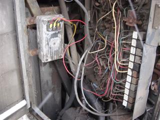

Tim (Timkar)
Username: Timkar
Post Number: 82
Posted From: 24.64.223.203
Posted on Saturday, December 01, 2007 - 10:48 pm:
As promised here are the results of my findings.
Checked voltages at regulator and they were the same as at the batteries. Took wires off regulator anyway and put new terminls on. Starting tracing wires and found a wire at a "voltage regulator" relay in the rear wiring area which wasn't making contact.(Red one in picture) Cleaned end of this and got it back in to relay base. There is now a very slight pulse, barely noticeable at the lights and I am seeing approx .2 of a volt fluctuation on my meter. Started getting too cold and the snow is accumulating. I have removed the batteries and will charge them all so that when I try again I know that they are at full charge.
Thanks to all....Tim

Posted on Sunday, December 02, 2007 - 4:19 am:
Tim,
We greatly appreciate you posting your findings, it helps us all to know when our diagnosis is correct. From the pictures, it WAS time to quit!
I don't feel that battery state of charge matters, the issue will be another bad connection, or two. A suggestion would be to remove the regulator, sand the mounts and the frame underneath where the reg mounts, and replace.

Posted on Monday, December 03, 2007 - 4:12 am:
Tim, thanks for posting the pics. You and I have the same regulator except mine is mounted with the terms on the bottom.
George, I know that the mounting area looks a bit rusty but the regulator is isolated in it's phenolic case & grounds by one of the three wires: Black = ground, Red = B+, Yellow = Field.

Posted on Monday, December 03, 2007 - 6:20 am:
Jim-Bob,
I don't want to split hairs here, BUT, the black wire is headed right for the upper right mounting screw on the regulator bracket. We can all guess whether that is where it grounds, or somewhere else, which isn't the point.
The point is that of the three people with pulsing charging systems, two of them have cleared their problem by repairing bad connections, as suggested. I won't mention the third...
