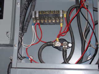

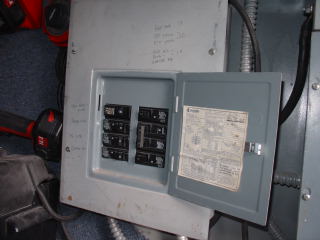

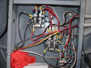

Ok Fellas Here are the pics of my Elec panel let me know what you think.

It looks good.
I assume that the relays are being used to switch between the shore power and generator power. They look to be rated for at least 30amp.
I'm doing a similar set-up with relays that will be interlocked. If I'm plugged into shore power and someone starts the generator the generator will run but the power will not get to the system until the shore power is disconnected. The same but visa-versa will happen if the generator is running and the shore power is plugged in.
If/When I get an inverter it will be done the same way.
