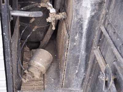

Here's the bus!
The last 2 are of the short circuit I encountered before leaving and an "air canister" What is it? Can it be removed?
dg
Username: Dreamscape
Post Number: 30
Posted From: 64.40.223.242
Posted on Tuesday, June 26, 2007 - 6:53 pm:
Very nice coach Doyle! Someday ours will look that nice, well it will at least look better than it does now. Don't know what the canister is though, sorry.
