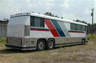

I worked the outside first, to get it to look like a decent motorhome
just in case we needed it to evacuate and had to stay at some
campground that usually refuse home-built looking RVs.
The seats, rails, luggage racks, and toilet are out. The ramp is
now the same height as the floor (that was the easiest job)..
The AC is out, totally, front and rear. The bus is now ready
to be rebuilt into a motorhome (except it won't be by me)....
