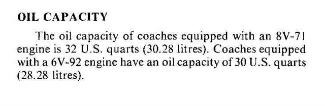

Username: John_mc9
Post Number: 42
Posted From: 66.217.106.104
Posted on Friday, August 04, 2006 - 1:34 am:
From the MCI MC9 manual1984-01-1, Page 8-2:
oil-capacity
I hope that's of some help?

Guys: Now I'm real confused. After hearing your answers with several variables, I called Detroit Diesel direct and spoke with their service support. I was advised by "P.J." that the proper fill is 27 quarts including oil filter and lines. He said it should be 1/2" below the seam between oil pan and engine block.
Now I read John's post from his manual which indicates 32 qts (8 gal), which is what we have been running, and so many have said is incorrect.
