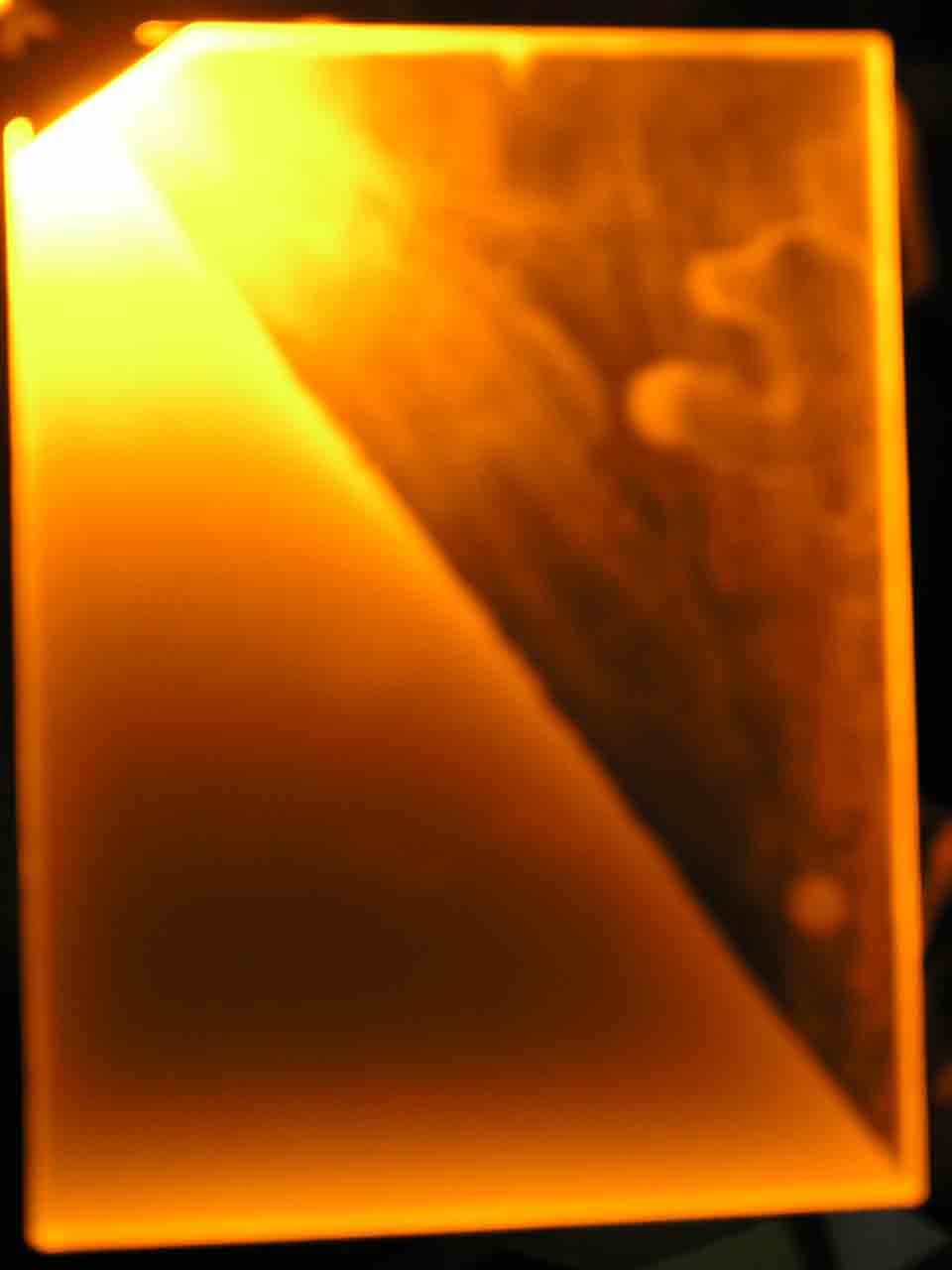

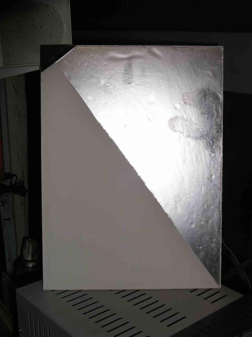

So after posting earlier, I said "Heck I have a few spare 3 Watt Luxeon Side Emitters laying around - I should hit Tap plastics and put my $4 where my mouth is." So I bought two pieces of plastic - the one I'm focusing on is called "P95" or "Matte Clear". This plastic is clear PMMA (acrylic) and has a matte finish on one side - but a glass smooth (actually silicon smooth if you are in the know on how they make that plexiglass so flat...) total cost 50 Cents (it was out of the scrap bin - but still about 6"x8"x1/8"). I'm going easy on this first test - I'm not going for light uniformity but just to get an idea of the light options. I'm putting the LED in one corner of the plastic in a 1/4" drilled out hole (all the way through). Going diagonally through the LED's hole, I'm doing half of the plastic with 24 mil silver Mylar from TAP ($1.42 per foot), and half of the plastic with the white paint. These treatments are being put on the glossy side to internal reflection properties. I screwed up the mylar film side initially by using a brush to apply an acrylic cement - which still had some model paint in the roots, so the mylar side while adhered, is a little streaky. I think the point is going to be moot anyhoo. For giggles, while I'm waiting for the paint to dry, I took a Mini-Mag light's head off and stuck the bulb where the LED is going to go. The difference was obvious. The painted side did a much better job of directing the light towards the matte surface of the plastic than the Mylar side did. I'll try to post a picture of what a single Amber LED can do when used in a non-engineered el-cheepo planar lightpipe some time tomorrow. Basically what I can say now is: "Don't waste your time with the Mylar for the backing of the main surface." It's not looking like it's worth the investment in time and effort (did I mention that it gets finger prints very easily and can crease without so much as a breath on it? What a pain.) Cheers! -Tim |
Tim Strommen (Tim_strommen)
Rating: N/A Votes: 0 (Vote!) | | Posted on Saturday, April 15, 2006 - 9:07 pm: | |
So here are the results of a quick and dirty demo of a 6" x 8" x 1/8" half-n-half panel. This is what the panel looks like - note that I have not treated the front of this piece with anything - so a lot of light will find its way out of the plastic before it reaches the end of the sheet:
This is what it looks like with a single 3 Watt Luxeon Side Emitter LED in the corner of the sheet (it's covered by the small triangle of mylar). Note that the mylar side causes the light to leave the plastic very quickly and how the white painted side allowed the light to go further and more evenly and the far edges allowed more light to be redirected outwards.
For those who choose to do this in a full panel, I'd recommend using one LED every 4-6 inches to even out the light distribution. Also, it will help if you paint the portion that will not have the silk-screen or scratched surface to keep light inside the plastic. Cheers! -Tim |
