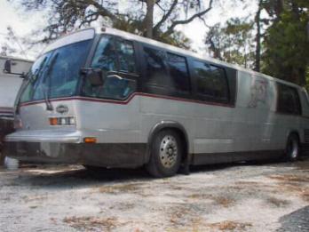

I am not sure why RJ is always attacking the RTS as a conversion, I have one and it makes a GREAT conversion. Having to change differential gears (if necessary, many are already geared for the highway since they are used for commuting routes)is not that bad. At least you don't have to raise the roof on an RTS and it is available with OPENING windows. Unfortunately, RJ is singing to the choir on this board and I am getting tired of arguing about it, so if anyone want to know the truth about converting an RTS (not just "transit"), please visit the Yahoo RTS bus nuts sight:

Posted on Saturday, July 02, 2005 - 2:56 am:
Geoff, I think you might have liked it better if
RJ had said "inexpensive transit" rather than "cheap transit". At least, that was the impression that I got when I read it.
I suppose the statement "Most are well-worn out when auctioned off" didn't help much either. Do you think that he was wrong?
I was told by a fellow in Perris, CA, that they are heavy, and it's hard to get very good fuel mileage out of them.
I think that the 6V92 is a plus, but the gearing, weight and automatic all take a toll on their economy.
How well does your RTS do?
Tom Caffrey PD4106-2576
Suncatcher
Geoff (Geoff)
Posted on Saturday, July 02, 2005 - 1:52 pm:
Hi, Tom
My conversion weighs 32,000 lbs and gets 7-7.5 mpg with the 350HP 6V92TA. So you see that the bus doesn't weigh anymore than a three axle conversion usually weighs, and does well on fuel since it is shorter and aerodynamic in design (the RTS was tested in a wind tunnel as part of it's design process). Driving the RTS with it's Sheppard steering box and low-lean suspension makes it feel like you are driving a huge mini-van. The view out the large front wndows is excellent while traveling. The RTS makes an excellent highway coach and it is hard to tell if you are going 60 mph or 70 mph, mine tops out at 78 with the 4:10 rear end.
Getting back to RJ's "digs", the RTS is used by large transit agencies and normally receives excellent fleet care and are often retired with 500-600,000 miles on the chassis. Many are used for commuter service and are run on the freeway between cities (such as my ex-Golden Gate Transit bus). There have been over 20,000 RTS's made, and there are many bargains out there in used buses.
To end this, let me point out that making storage bays in an RTS is quite simple-- the space is there you just have to utilize it. I have two full, pass through bays on mine that are 5' wide and 20" tall, the other two bays house the holding tanks, propane bottle, and Webasto along with the fuel and air tanks. The diesel generator sits above the engine compartment where the old air handler was. So you see there is plenty of room for storage and conversion necessities in an RTS. Did I forget to mention RTS's are a good looking bus?
--Geoff

Heh heh... Jimmie... U rokkin' D boat!
Actually, after seeing Pete's RTS, I kinda wish I bought one.
They're inexpensive, easy to convert and provide more room
than a same-sized commercial RV. They can look great from
the outside with a modest amount of work! Sure, the wheel-wells
are a pain to have to work around, but I'd bet you can buy
an RTS in better condition for less money, than any MCI
or Prevo.
