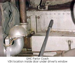

The VIN on your coach should be in two places: a placard riveted on the dashboard above the second entry step and emergency equipment access door, and inside the exterior compartment directly underneath the driver, stamped on the "frame rail". See the pics:
dash
frame
BTW, what is the VIN on your 4104?

Thanks for info on both posts it answered my questions. Roy
