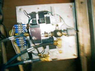

I have designed / assembled / tested a number of (Air over auto levelers) systems. I have been acquiring high quality new and used soleniod valves for the last year. I have started putting resonably prices packages together. The system I designed and installed on my RTS conversion can raise or lower any corner almost 12" does not use check valves does not leak back thru the valve when parked and the supply air drains away Has no operating minimum air bag pressure - can drain the air bag to zero PSI - The design and valve soleniod selection allows 3 settings: Auto - Levelers functional ADJ - Manual Fill and dump (Raise and Lower) HOLD - while parked - or to override auto levels alavailable with 12 or 24 volt soleniod coils I supply all the valves (Fill-Raise / Dump-lower / Isolate-auto leveler) valves and the wiring/pneumatic diagrams - you supply the electrical switches / lines / fitting / install labor- to match your buses requirement - @ $100 to $125 (depending upon valve selection) per CORNER available in 3 or 4 point/corner systems I also installed electrical pressure senders on my unit the monitor my air bags and suspension supply and alarm at adjustable set points (low and high) http://www.airbagit-store.com/product.asp?returnURL=default.asp&ID=84697
Pete Papas RTS/Daytona - DBA (D.P.Solutions) Ormond Beach Florida 386***672***0571 .____________ /_][][]/____/[]_| 1989 RTS-II T70206 6V92-TA DDEC-II V731 4.10/24.5 *--O-----------O-* Daytona FL.-Hard Beaches/Soft Women P.S. Using the auto levels and changing the length of the adjusting rod can have a draw back - as you move around - (get in get out) of your bus the auto levels will keep adjusting - until there is no longer enough presure in the suspension tank to return a corner to its adjusted height setting |

Pete that sounds like a good price. What size lines do you use? Also is it all mounted up front? Also good point on the changing the length of leveler valves . You would need a air compressor to to keep the air up all the time. One thing I found out with mine It has the opitinal HD sway bars front and rear is if I have air in the front and air in the left rear and let all the air out of the right rear my bus will not come down on the right. Im sure when its finished converted with more weight it will come down. I need to let air out of both side to get it to tilt. But having conntrol over the air bags is one of the best tools for doing work under the bus by lifting it up and also use of proper blocking to keep it up. I never leave home without the blocks for repairs on the hwy. I also have spacers the fit between the axle and the rubber bumpers so there is no way the bus will come down and jack stands under the axle. Nothing short of a sink hole will bring my bus down on me. Can you tell Im bored held hostage here not working on my bus Brian 4905 Klamath Falls Oregon (Kanasas City) |
Rating: N/A Votes: 0 (Vote!) | | Posted on Saturday, March 19, 2005 - 10:22 pm: | |
Brian Line size - just about any size - all the valves have 1/4 NPT fittings they can accomidate 1/4 - 3/8 - 1/2 dot plastic lines. Each valve has a Cv rating (flow rating) of approx 1 to 1.5 cv that's 7 to 10 times more flow than the bus air leveler schrader valve - so manual raise and lower happens much quickly then thru the auto leveling system (which needs to be slower) Mounting - I prefer to mount the control solenoids under the floor of the bus and near the leveling valve for accessiblity (most of the valves I use have manual overides - just in case). I used 4 wire trailer cable to wire mine (one wire each for raise / lower / auto / separate ground) and a shielded wire for the pressure sender - only the control switches get mounted up front Pete RTS/Daytona |
