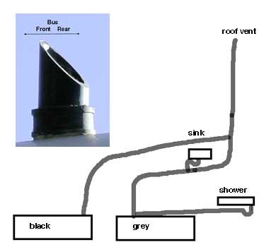

I'm getting to the point where I need to install my vent pipe from the holding tanks. My dumb question is "How did everyone seal their vent pipe?" My thought was to cut the hole, and get a flashing from home depot and just silicone it. Am I missing anything? I seem to remember someone posted that they cut the hole very close to the size of the pipe, then cut one of those rubber couplings in half and used half on top and half on the bottom. this would also tie it together mechanically. I'm not sure how that would seal, or how the rubber would hold up to years of sun. Any other ideas? |

I like to keep things simple. Standard RV roof vents are low profile and not particularly unsightly. We used the base of one of those and just have a PVC tee on top to do the ventury thing on the road. Since the roof is covered with a Kool Seal type of stuff, there is no possibility of leaks. |

I used a large rubber grommet intended for connecting waste pipes to holding tanks. This made a very good seal where the pipe went through the roof. I installed the standard RV vent flange and cap assembly which was large enough at the base to clear the grommet and sealed this with caulking. No leaks so far. Dave Dulmage (MC-8) |

I'm da one that got a flexible pipe coupling and cut it in half, stuck one half inside and the other half outside, clamped them down with the hose clamps that came with them, and gukked some silicone inbetween. It's worked famously for three years now.... |

PS, I cut the outside of the pipe at a little angle so it acts as a venturi that sucks on the tank when underway. That way when you're driving and the wife uses the pottie, the cabin doesn't get stunk out! Here: http://www.heartmagic.com/00ventstuff.jpg |

I got the "Home Depot" standard sheet metal & rubber flange, Drilled a circle (I did not have anything else to make "Perfect round" hole) it looked kinda slopy but I made sure that the 1 1/2 inch ABS pipe fit snug through both inner & outer skins of the roof. Then I siliconed the around the pipe with 50 year clear silicone(pipe to roof), Cut the sheet metal (with shears) to a proper size for bus roof, siliconed the underside of the sheet metal heavily (Two 1/4 inch beads, one at outermost edge of the sheet metal flange other closer to vent pipe), & slid it over the vent-pipe. pushed it down onto roof(things got kinda messey at that point), Then drilled 1/8 inch holes in both sheet & roof all the way around the flange, siliconed around each individual rivit (one at a time) before inserting them, used a pice of nylon bug screen (stuffed it into the vent pipe)& I used a standard "mushroom" type RV roof vent (the kind that slides an attatched metal flat-spring onto 1 1/2 inch ABS), then painted the whole thing including the ruber seal. 5 years & 10 months ago. it never leaked. I stayd in an extreemly fogy, dewy, El'Ninio riden spot under a tree that sheads heavily more than once per year for 2 winters in a shaded area (even had to scrub the alge from the shady side of bus twice!) NEVER leaked once! It is still good today. 2'nd time painted this spring. seal is still good after 5 winters (in that wet area)& 1 summer in Mojave Desert Sun!. Worked for me, I wold do it like that again. Although the vent into eng. intake might help limit the tailgaters! LOL! S.M.H |
