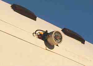

__. Does anyone have experience with a "rear view" camera? I have excellent rear vision from my bus but it seems to me that one of these cameras mounted along my roofline might be good for spotting clearance. __. Some of you may remember that I have an English double-decker bus which is 13'6" high -- right at the legal limit (in Eastern states) and there may be some clearance issues (low hanging traffic lights, for example). __. I'd like info on your experience with these cameras, as well as supplying companies, costs, etc. Many thanks, Bruce Henderson, Wallace NC |

I think the point got lost here. The rear view camera goes high up on the back of the coach, not on the roof. It should never get near anything scraping along the roof. They are great for many uses. There are closed circuit units, costing less than $100, that can be modified for use on a coach. Modification includes reversing the picture left to right so it is like a mirror image. See my article "Rearview TV" in the July 2003 issue of Bus Conversions. |

It amazes me how quickly the actual question gets ignored and the topic wanders off!! That said, yes, the cameras are great. For going in the forward direction, just a normal camera will be perfect for you. If you'll be using one for backing up, you'll either have to look for a complete package (camera and monitor) so that the image in the monitor is reversed. It is totally un-nerving to use a monitor system that is "normal", be driving around with it on, see someone passing you on the right in the monitor and then they actually pass you on the left! To get a properly reversed system either purchase a complete monitor/camera package that is reversed from the factory... or you'll have to get a normal camera and a CRT based monitor and reverse the horizontal yoke wires yourself to reverse the image. I don't like either of the above options because I like big ugly things like monitors on my bus to have more than one function, like watching TV or DVD's, or viewing my GPS system. With a dedicated "reversed" monitor, you can't do that. SOOO... You can easily find individual cameras that have a reversed output ..OR...(this goes on!) you can find units like "Video Mirror" from Colorado Video that will reverse a video signal from a normal camera (this is what I do). Once you've figured out the "reversing camera" problem, you can find a $50 box called a "UNIVERSAL VGA BOX" that will allow you to use a regular camera to feed a large VGA LCD computer monitor- that's what I do, and then you get an economical large display in color. An advantage of using the VGA box is that you can also add three more cameras and a computer and select them with the push of a button. For your particular appliation, here's a hint that works VERY well for me. I put my camera on the roof of my bus, slightly in from the rear so it sees part of the roof as well as the road below. (I have a curved rear) Then I placed a bunch of 2/4's on the driveway in two lines, positioned so that if I backed straight up they made a little "lane" that was only a few inches wider than my bus, and I wouldn't hit them. A lot of guys will then put marks on their monitor, right over the "lane lines", so when backing up, they can see if there's anything between those lines, it'll get hit. Since I also use my monitor for DVD's and GPS, I didnt want to do that. Instead, I painted two lines on my roof that the camera sees, which create a set of guides in the camera. For you, perhaps you could mount the camera back on your roof a ways, aimed straight ahead so the bottom half of it sees nothing but your roof, so if you saw a bridge for example and no light between the bottom of it and your roof top, it'd be a prudent time to stop. If it were me doing this, here's what I'd recommend: A "normal" camera looking straight ahead; A "reversed" camera looking to the rear A VGA box to select the camera and convert to VGA A 13" to 18" VGA monitor hung about where your rear view mirror would normally be One more thing- for backing up you want a very wide angle camera so you can see everything. Over 100 degrees view angle is desired. But for your application in the forward direction, you really don't want a wide angle camera, because you aren't as worried about running trashcans over as you are hitting low hanging things. A camera that was NOT fisheye or wide ange would be better because it would act more like an early warning for things fairly far away, and the image would be a lot less distorted as well. I'd think maybe a 60 degree or so would be better for the front... check out the supercircuits link below and look at their PC67S-2 camera. (They also sell housings for it) Sources: for good cameras that reverse the image- Look up seller "yanlabonline" on ebay- get the more expensive ones though. (You always want to go with the highest resolution you can get, in any camera) For many high quality non-reversing cameras check www.supercircuits.com (I got mine here) http://207.207.29.130/store/products.asp?dept=12 (most of their cameras don't reverse but they do have a few) For a VGA box, this is the one you want: http://www.whitedog.co.uk/catalog/product_info.php?cPath=12&products_id=475 although the seller is in the UK. With some searching you can find them in the US though...ebay? Colorado Video, http://www.colorado-video.com/mirror.html these cost over a grand from them- to date I've bought two from ebay, one for $30 and one for $1.99... keep an eye out and you'll find them... |

Another way to reverse the image is to mount a mirror at a 45 deg angle in front of the camera. You will have to play with the mounting angles to get the image you want. |

Gary Stadler said: <<>> __. Thank you, Gary, this is exactly the kind of useful and helpful information that I was seeking. Many thanks! __. Actually, the rear view system on my bus (there is a central rear view mirror that looks down the center isle through the rear window, in addition to a pair of large outside mirrows) is very good. The only thing that I'll need the camera for is overhead clearance so I anticipate only a forward-looking one. But your information and especially the weblinks will be very helpful. __. Thanks again for the kind and helpful reply. Bruce Henderson, Wallace NC (And I'm aware that the legal clearance is 13'6" but it seems to be a fact that you will occasionally meet an overhead road sign or traffic light or phone line that's loose or hanging from a heat-stretched cable. Say you only run into that kind of problem once a year -- I don't want to be spending money and time repairing scratched paint and windows; even once a year. Much better to have a system that gives me a full picture of what's happening up there.) |

Tagging along on this question, does anyone know where to get those slick RV housings for bucams? My situation clearly won't last long in sun/wind/rain.

Chuck....3" or 4" pvc pipe coupling |

R&M fiberglass near Salem Oregon sells the camera pods. they are expensive, $150 or so. Bigger than you need it looks like. |

You can bend Lexan with a regular sheet metal brake. Just bend up a small piece into a guard for it, either clear or tinted will work, depending on just what you wan to do. Much cheaper than a premade anything most of the time and you have exactly what YOU want. |
