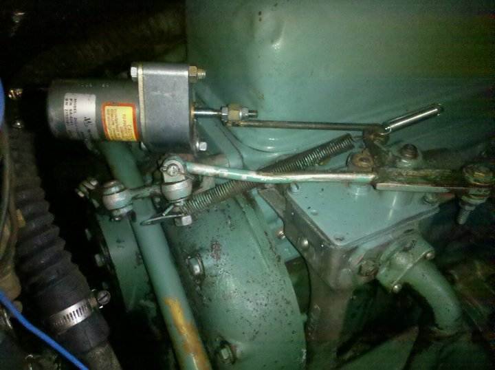

Brandon what kind or type of electric solenoid did to go to for the shut down. I still have the air but sometime I get little water in line and valve and when you come back from eating supper it will not start due to water that is holding the lever in shut off. Like to change my 6-71 over to electric. Thanks |
Brandon M (Brandon314159)
Registered Member Username: Brandon314159
Post Number: 70 Registered: 3-2011 Posted From: 173.8.221.225
Rating: N/A Votes: 0 (Vote!) | | Posted on Tuesday, February 07, 2012 - 6:55 pm: | |
Steven, here is a picture of my setup:
The trick is to get the solenoid to fully seat when in the 'on' position. This disconnects the pull-in coil and activates the 'hold' coil. Not having this seat will burn the solenoid up in short order. These are readily available all over ebay/etc. |
