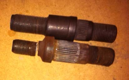

I need help finding the correct part. When I ordered the lug part number from my parts book, the stud is way different than what I pulled out. It's 4-3/4" in length, 3/4" on the lug nut side, 1" at the knurl, and 7/8" on the part that bolts on the back side of the hub. I'm going to try and attach a photo. This was a real bugger to get out by the way. http://www.avonpicturethis.com/stud.jpg <-- Photo of broken Stud |

Top stud is what showed up when I ordered the GM part number in my book. |

Oh and it's for the rear, budd nut style with a inner threaded stud for the 1st tire and a outer lug nut for the outer rim.

Take them to a truck parts place so they can match them up. You would be surprised at how many different ones they have. |

I will second Ed on this one. Finding replacement studs to convert from the TDH-4512 pilot style lugs over to Budd was tricky. I eventually ordered my studs from local PDX place, and got the nuts/etc. from Ryder Fleet Services online...good selection. Take care, |

I went to the tire shop across the street from the major truck fuel stop, he had a wall full of bins with different studs. Side by side comparison & a wheel expert are all you need to straighten out this l'il deal . |
