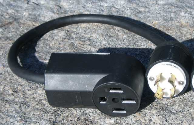

Sean Welsh (Sean)
Registered Member Username: Sean
Post Number: 1281 Registered: 1-2003 Posted From: 72.171.0.148
Rating: N/A Votes: 0 (Vote!) | | Posted on Sunday, November 06, 2011 - 4:42 pm: | |
I happen to have a photo of the surface-mount device I mentioned in the last post. In this case it is being used with 10-gauge SO to connect to a 3-phase, 208-volt twist-to-lock plug, but you get the idea:
-Sean http://OurOdyssey.BlogSpot.com |

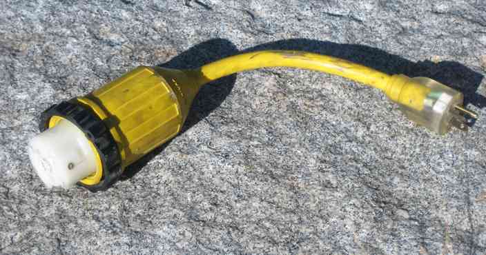

Rating: N/A Votes: 0 (Vote!) | | Posted on Sunday, November 06, 2011 - 7:47 pm: | |
Les, The adapter I have is a Midwest and it goes from 50A 240 to 15A 120. It is just one adapter, so no 30A can be used. But this adapter does heat up both legs. |
Gary Seay (Gdude)
Registered Member Username: Gdude
Post Number: 87 Registered: 6-2010 Posted From: 209.112.222.154
Rating: N/A Votes: 0 (Vote!) | | Posted on Sunday, November 06, 2011 - 8:10 pm: | |
Here is a pic of the adapter I have [IMG]http://i1197.photobucket.com/albums/aa439/seayfam/myphone338.jpg[/IMG] [IMG]http://i1197.photobucket.com/albums/aa439/seayfam/myphone337.jpg[/IMG] |

I am looking at the adapters that are on the camping world and the Wal-mart pages and have realized something. They don't match the male plug on my coach. My Plug has 3 tines, something like a twist lock and then a ground on the outside edge The adapter female plugs have 4 tines, 3 straight and one somewhat rounded for the ground. I got the male plug from an R.V. dealer. It is marked on the inside as 50 amp 220 volt. Could I have the wrong male plug on my coach? Why would a RV dealer have the wrong inlet plug, let alone sell it to me? AAAAARRRRRGGGGG!!!!! Thanks, I feel better now Les |
Post Number: 1293 Registered: 10-2004 Posted From: 66.87.107.230
Rating: N/A Votes: 0 (Vote!) | | Posted on Thursday, November 10, 2011 - 9:17 pm: | |
It could be you have a marine plug! Post a picture! |
Post Number: 784 Registered: 7-2004 Posted From: 67.141.67.144
Rating: N/A Votes: 0 (Vote!) | | Posted on Thursday, November 10, 2011 - 9:31 pm: | |
As Ace said, is it a Marinco or Hubbel plug? |

Les, that's a Marnico-style inlet and it is standard for 50-amp RV connections. Many shore cords are sold with the proper mating female connector already attached. This is the type of inlet I have on my coach. As you noted, it is a four-wire connector, with the two hots and neutral on blades, and the ground on a circumferential pressure tang. This connector was designed by Marinco for the marine industry and does not have a NEMA equivalent. However, it is UL and CSA listed for RV use. -Sean http://OurOdyssey.BlogSpot.com |

Thanks Sean. I guess that means getting a pre maid 50 to 30 amp adapter is unlikely. I will make my own. After the guys suggested that it was a marine plug I realized that it is the same style of plug that our boat has and that they were right. I won't change the plug now as it is installed and looks very good where it is. Onwards and upwards! I hope things are going well with your power steering problem! Les |

Les, The pre-made 50-to-30 adapters are intended to go on the plug end of your shore cord, which should have the standard NEMA 14-50P "range"-style plug on it. If what you want is an adapter that instead goes on the shore inlet of the bus, Marinco does sell those, and you can find them at some RV stores and on line. However, they are pricey. For that matter, even the wire-it-yourself female cord end is pricey. I do have adapters that I made with these myself, such as this 20-amp one:
The adapters made for the cord end will be cheaper and easier to find. FWIW. Steering is fixed, thanks. -Sean http://OurOdyssey.BlogSpot.com (Message edited by Sean on November 11, 2011) |

Thanks everyone. My power inlet is a marinco 50 amp 110/220 volt. I found the female plug and a male 30 amp plug to make my own adapter. It works Les |

Hey, Les, I apologize for asking but can you post the type number for the plug and socket that you used? I think that they'll have numbers like "NEMA 6-30P" or "NEMA 6-30R". And a photo will be really nice, too. Many thanks, BH NC USA |
Sean Welsh (Sean)
Post Number: 1293 Registered: 1-2003 Posted From: 67.142.130.44
Rating: N/A Votes: 0 (Vote!) | | Posted on Thursday, November 17, 2011 - 5:38 pm: | |
Bruce, The Marinco inlet connector (as pictured in my post above) is not a NEMA standard, so it will not have a NEMA type number on it. True for many of the marine-style plugs. The shore end of the cord will have a NEMA 14-50P plug for a 50-amp service, or a TT-30P plug for a 30-amp service. -Sean http://OurOdyssey.BlogSpot.com |

Thanks for that info. So, using this adapter, you'd just run an "ordinary" 12-ga three-prong extension cord from the pole or wall socket to the bus and use this adapter between that cord and the vehicle? Sorry, I'm not experienced with this. Thanks, BH |

Bruce, The adapter in the photo is one I made myself. Hard to tell in the photo, but that's actually a 20-amp plug on it, not the standard 15-amp type, and it is a 10-gauge cord. I have a 50', 10-gauge, 20-amp extension cord that mates to it. I also have a 5' long, 15-amp to 20-amp adapter if I can only find a 15-amp receptacle, although in that case I typically use a completely different cordset that has the Marinco female end, 50' of 11-gauge wire, and a 15-amp (NEMA 5-15P) plug on it. Frankly, it is easier for most folks to just use the store-bought adapters to go from your 25' or 30', 6-gauge shore cord to either the TT-30 or 5-15P as needed. We tend to plug into some pretty weird power sources, which is why I have a box with no fewer than a dozen different adapters in it. -Sean http://OurOdyssey.BlogSpot.com |

Bruce, Technically, the plug/socket assembly is supposed to be kept out of direct exposure to weather. When talking about connections you make yourself, such as at the coach inlet, or between two cords connected together, that's pretty easy. In the case of the inlet, mount it inside a bay or under a cover. In the case of cord-to-cord connections, you can make a weather enclosure from one of those plastic kitchen storage containers, with notches cut in each end for the cords to enter. When it comes to the campground pedestal, it's a bit harder to control. I try to rig the box cover, if possible, to keep direct rainwater off the connection. In all cases, a bit of silicone dielectric grease will help keep moisture out of the connectors themselves and slow the corrosion of the contacts. -Sean http://OurOdyssey.BlogSpot.com |

Thanks, thanks, again. My inlet is inside a hatch that was built into my bus for a long-gone central lubing pump. It's a small cavity but it's sealed from rain and also "road water". I like the snap-top plastic box tip, too, and I'll remember to pick up some di-electric grease for the first time it's all put together. I was thinking about cutting the bottom out of a gallon water bottle so it will drop over an electrical post - will that work? |

Sure, if it fits. Many campground pedestals are larger than that, though, and you also want to make sure you are not trapping any heat in there. -Sean http://OurOdyssey.BlogSpot.com |
