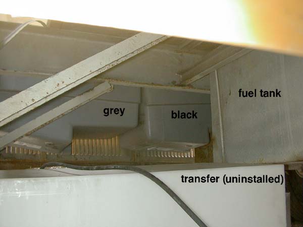

I have a different "hybrid" approach... I have a 35 gallon black, a 35 gallon "grey" and an 100 gallon "AUX" tank. The main reason for this insanity was that I have a strange set of places to put tanks of these sizes, so I did. The valving arrangement is such that the two smaller tanks are valved into a "manifold" that has a separate valve to the big tank and a final valve to the dump port. (That last valve, just inches from the dump port is REALLY nice to have, so when you remove the cap, there's no chance of getting it in the face) It turns out to work very nicely. On most trips I never use the capacity of either of the 35 gallon tanks, so the 100 stays closed and empty. When I dump, I first dump the black tank. Then I close off the final valve and open the grey valve for a few seconds... this backwashes into the black tank. Then I redump the black, this gives it a nice cleaning, I close it again and finally dump the remaining contents of the grey. On long campouts, when either the black or grey get full, I simply open it's valve "and" the big tank valve, and the contents drain (by gravity) into the big tank. It's just like doing a normal dump, but into the big tank instead of the RV station. Kind of nice to have a place to put the excess and start with clean tanks again!!! Here's an old photo prior to me having the plumbing in http://www.heartmagic.com/zzPoohTanks.JPG Here's a diagram of how it now is... http://www.heartmagic.com/zzPOOplumbing.jpg Weird but it works exceptionally well for me... Gary |
