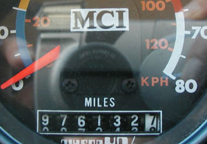

I know, I hate those subject lines that don't explain what the thread is about. But it's almost halloween. So consider this -
The coach has already passed several of my tests, and I do plan to get it somewhat checked out by a pro. (so far so good - it's in very good condition) Would you consider this MC9 if it were you? |

Chucks, At least you know what mileage it has showing. Mine didn't have a odometer or a hubometer. If the motor starts easy and with little smoke, runs clean from cold, has little or few oil leaks, tranny drives nice and the brakes (check for wear) and steering look and feel good, consider buying it. Another things to check are the sound of rusty metal tinking down inside the bay doors when you open them, also look inside the spare wheel area, in the engine compartment and fan area for rust and cracks and also in the bays for same. Look down the sides for straightness, especially at floor level, any bulges could be trouble with rust. Think of anymore possible trouble areas and then, if all is ok, buy the bus. In my opinion, MCI is one of the best for conversions, squarer roof curves, clean lines, parts availability, low purchase price than some, and there's nearly always a mechanic that can work on a Greyhound in a town. Good luck. Peter. |

Chuck My 04 had 1,500,000 miles when I bought her. Some say that was low miles althouth it has not been a grehound. I,m told Grehound keeps them until they reach 5,000,000 any one have the inside scoop? John |

My 04 has around 3 million on it...... Chassis will only wear out from an accident or corrosion.....everything else is a replacable item |

The scariest part is that the speedometer lasted that long. Most don't. Jim |

With that many miles it is probably on it's third or fourth engine/transmission rebuild. So it should be running fine if the drivetrain is recent. What is not so obvious to find is how the steering and axle bushings are, stress cracks from so many miles, and just general wear and tear on everything. I have looked at buses with 500,000 miles on them and buses with 1,000,000 miles on them and the soundness of the bus is obvious between the two. --Geoff '82 RTS CA (purchased with 580,000 miles) |

Yikes! That is scary! I think I see a ghost in the reflection. The mileage, you mean? All depends on how the coach was maintained. I would not fret the miles if maintenance was good and rust is minimal or non-existant. |

Wow!!!...less than 25K until you have a brand new coach. Then you can change out the speedo for one that reads to 100 mph sosss you can race the State Trooper cars! |

Scary? Naw--that's only a little more than half what the 61 GMC Fishbowl at work has! |
