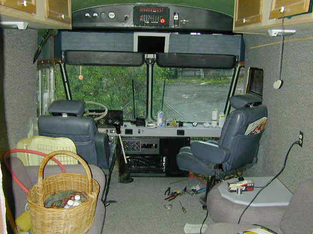

The "box" is called simply... "VGA Box" It is a neat little $50 item that, with the push of a button, selects one of four analog (ntsc) video inputs and converts them to VGA, or you can select the VGA input and route it straight thru. I have a 14" LCD computer monitor mounted where a rear view mirror might go, and using the VGA box I got from ebay, I can route my DVD player, my back-up camera, or my PC computer with GPS into it. It really works well, been on 8,000 miles worth of trip so far and worked flawlesly. Here's a photo, you can see the monitor between the sun visors just below my breaker panel: http://www.heartmagic.com/donefront.JPG So far the only drawback is that neither the monitor or the back-up camera will reverse the image. That was a problem until I found out about a neat box made by Colorado Video called a "video mirror"...simple video in and video out, but what comes out is reversed left-right. It's almost a grand new but I got mine on ebay two months ago for $39 !! They do come up from time to time although they aren't as plentiful as Big Macs.... Cheers gary |
