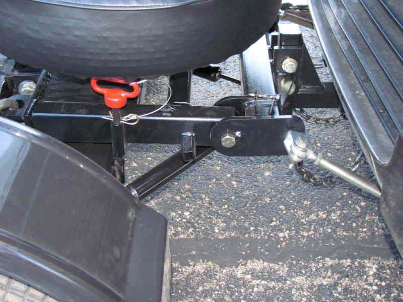

Ralph - You & I are on the same wavelength when it came to doing more research. You called, I emailed. We both heard back from Jok, the owner. (He said he would have posted here, but for the registration time-delay. . .) Anyway, the Trailer Toad is hinged at the front, like Ralph mentioned earlier. Solid mount into tow vehicle receiver attaches to adjustable solid mounting on TT's front cross-member. Has large bushings with zerk fittings for lubrication at pivot point on each side of the cross-member, as shown below. This allows TT to move up and down vertically, in order to handle driveways, railroad tracks, valley gutters, etc. - which was what Ralph was concerned about earlier and I knew nothing about. Here are three pictures Jok sent me, to help illustrate. This first pic is of the pivot bushing welded into the main frame of the TT.

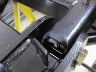

The second pic is of the cross-member attached at it's pivot point to the main frame. Note the zerk fitting for lubing the bushing.

All - This last pic is of the TT hooked to a Class A stick 'n staple. You can see the rigid drawbar installed in the hitch receiver, the adjustable drawbar brackets to level the TT to the tow vehicle, the cross member pivot points (gold-colored bolts), The red handled gizmo is one of the two locking pins used for backing up.
All in all, seems like a well-built unit that addresses a lot of the issues we busnuts face when towing a heavy trailer. A little pricey? Maybe, but FF hit the nail on the head when you compare it to the cost of repairing a failed engine cradle. The stick 'n staple crowd have it even worse, because heavy trailer tongue loads not only bend the frame behind the axle, but it also tends to pull apart the fiberglass box, too! (My neighbor works at an RV repair facility - tells very interesting stories of how the stick 'n staple rigs come apart after towing!) Lots of kudos on several of the auto racing forums - the guys who use them all seem to swear by them. It seems like it's only the folk who don't own one, have never seen one, or have never used one, well, they're the gearheads bashing the product. Ah, well, such is life! FWIW & HTH. . .
