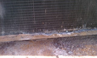

and a couple of my rusty radiator before it comes out! Doesn't look good does it!

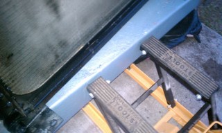

here's an update, everything I can possibly see and reach has been cleaned and painted, bringing home the radiator tonight and hopefully my new hoses will be at the house tomorrow. Saturday I plan on starting the install of the hoses and radiator. I know I must have removed about 30 years of crud. |

Rating: N/A Votes: 0 (Vote!) | | Posted on Saturday, October 02, 2010 - 11:12 pm: | |
Today after doing some estimates for my job, I had a chance to do some more work on the radiator change. I went and bought new bolts, washers, and nuts and after Susan touched up some missed areas that were painted I decided to set it in place. This was the part I was dreading but it had to be done. I used my brain rather than my back and it was a very easy task to say the least. I dollied the radiator in place using my two wheel dolly and then stood it up just outside the hole where it would reside. As I lifted one side up, I had Susan roll my motorcycle lift under it and position it in the middle. As I steadied the radiator, she pumped the lift and raised the radiator to the height that it needed to clear the frame. To my surprise, the lift only went so high but when maxed out, it was exactly the height as the frame. Once it was all the way up, I had Susan lock the lift in place by screwing down the bolts which dug into the concrete. Once this was done, I simple walked the radiator in place and secured it with one of the two upper mounting bolts. The bottom bolt holes are perfectly lined up and ready for new bolts. When the mosquito's started swarming, I was done for the night! The clamps are soaking in solvent and my new 4 different size hoses came on Thursday. I still have one large water pipe to RE-paint due to our famous Florida LOVE BUGS attacking it while I wasn't looking. Tomorrow (Sunday) I will get more done for sure and maybe get it completely done, (hopefully) just in case a storm comes and I need to leave! Again, the motorcycle lift made this "ONE EASY JOB"  |
Post Number: 1076 Registered: 10-2004 Posted From: 75.201.115.235
Rating: N/A Votes: 0 (Vote!) | | Posted on Saturday, October 02, 2010 - 11:30 pm: | |
Here are a couple of pics!
