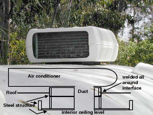

I didn't have the center strut problem in my Crown, however the "how to" was about the same, problem wise. I ended up cutting my 15x15 hole in the roofing sheetmetal and then (very carefully) welding a frame made of 1/2 x 1" rectangular steel tubing into the hole, so it sticks up an inch above the roofline. When done I sprayed the welds and the frame with a few heavy coats of zinc-rich galvanizing primer, both inside and out. This makes a very waterproof and extremely strong interface. If you had a structural rib running under it, it wouldn't matter (it would actually help), and now that the frame is there, more structure can be welded to it from below if necessary. The fact that it's top surface sticks up an inch above the roofline (thus leaving a good gap between the bottom of the AC unit and the roof below it) makes it almost impossible for water to find it's way in, and it also discourages pooling and moisture buildup under the AC that I have seen totally ruin many RV roofs. The rectangular tubing gives a very flat, strong surface to mount the AC unit to. Just a though and a different approach... Cheers Gary |

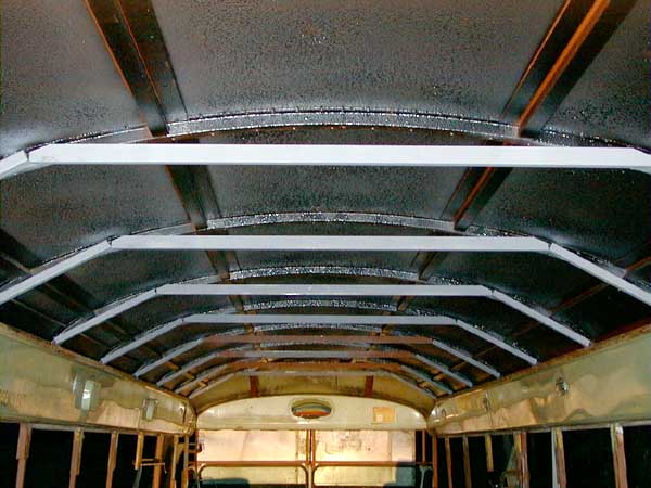

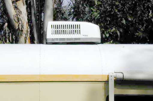

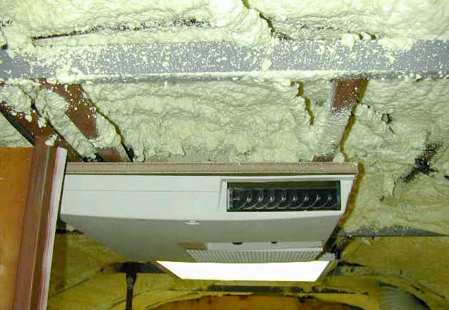

Hmmm RC, I guess I'm the one who missed the obvious, not you !! ...Turns out that way back in '62, my Crown was ordered as a "special" with no back doors, a nasty high ratio on the rear end (5:29 ugh) and the body to be made of all steel. So with exception of the front and rear caps and the actual front panel of the bus, there's not a drop of aluminum anywhere on it!! It has certainly made things like moving the door to the side, paneling in the windows, etc. MUCH easier on me than had the bus been all aluminum!! I have seen A/C's plopped straight on an RV roof (sheet steel roof that is), gather moisture between the AC/roof interface and rot the heck out of both the roof and the bottom of the AC. So I decided to do mine more like a skylight in a house, and raise it up a bit. Structure-wise it's now extremely strong, and there's not a chance of water building up, rusting things, or getting in. Here's a fw photos- I don't have many pre-installation photos so you can't see it all... Here's how I welded in rectangular tubing (grey) to support my interior roof, and make space for the foam insulation. I welded the AC frame down to these supports once it was welded to the roof http://www.heartmagic.com/00CelingRibs.JPG Here's a closeup and a drawing of how the structure goes... http://www.heartmagic.com/00ACinstall.JPG Here's what it looks like from the outside http://www.heartmagic.com/00RoofairOutside.JPG Here's what the insides look like now that it's done. You can see some of the supports (the reddish metal) welded to the grey ribs http://www.heartmagic.com/00RoofairInside.JPG Cheers Gary |

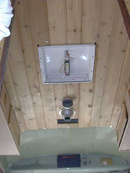

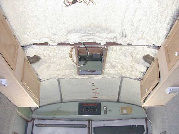

Rating: N/A Votes: 0 (Vote!) | | Posted on Monday, March 17, 2003 - 8:54 pm: | |
I raised the roof of the bus exactly one foot, so headroom after installing the cedar T&G that I used for my ceiling is two inches shy of 7 feet. For you tallies it may not be enough but the wife and I are 5'7 and it seems to us like forever up there!! Here's a couple photos showing the A/C structure just after foaming http://www.heartmagic.com/00RoofFoamed4.JPG and with the cedar installed http://www.heartmagic.com/00CabRoof2.JPG The fluorescent light has since been converted to 12 volt ballasts. I like em a lot. Cheers Gary |
