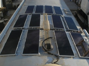

I helped a friend put these up on his camper. http://www.harborfreight.com/cpi/ctaf/displayitem.taf?Itemnumber=90599 If you get a Harbor Freight catalog or are a prefered coustomer or use the mail adds and the 20% discount coupons the price is even less, significantly. He got the 3 panel kits (45 watts) for 159 bucks or, less than 4 bucks a watt! He bought 4 kits so thats 180 watts for about 700 with tax!! Fun project. I am looking forward to doing our camper some day. Sorry for the thread creap

quote:He got the 3 panel kits (45 watts) for 159 bucks or, less than 4 bucks a watt!
Joe, that's about average for 15-watt panels. remember that larger high-yield panels are harder to make, which is why they cost more per watt. The power density of these units is half that of their larger and more costly cousins, and they weigh about three times as much per watt. All of which makes them a poor choice for a conversion. FWIW. -Sean http://OurOdyssey.BlogSpot.com |
