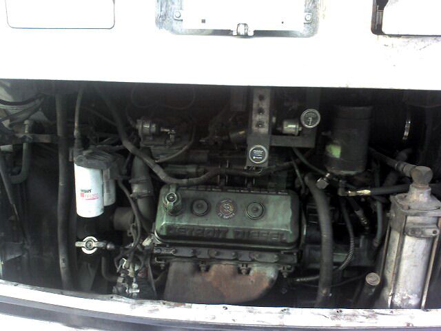

Hello all... My name is Shawn, and I used to have a 29' Neoplan with the 8.2L fuel pincher. I had planned on converting that over to a RV, but the engine was shot and Neoplan having gone under, I decided to part ways with the little bus. I now have a 35' GMC/Blitz RTS bus I know this one will be around and probably serve me a little better than the Neoplan. Easier to get parts for that's for sure... My question is this...for whatever reason, and I understand this is very unusual, but blitz put in a reliabuilt 6v71...
What can I do to add a little bit more power? I live in Florida, so Its really not like I'm dealing with mountains, but a trip back to PA may happen someday. I cant really afford to replace the engine with a 6v92, so I need to work with what I have... Also, would a change to "highway gears" do anything? Thanks for the input, I really appreciate it Shawn |
