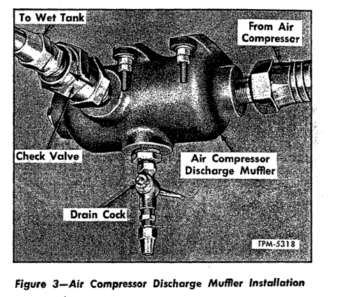

Mac Muffler also called a Ping tank is what you said you had to Crawl under to get at names LOL |
Post Number: 297 Registered: 12-2000 Posted From: 72.187.35.208
Rating:  Votes: 1 (Vote!) | | Posted on Tuesday, October 20, 2009 - 9:02 am: | |
The compressor discharge muffler is the very first little tank after the compressor, also called the "ping tank" |

where would this be on the bus? |

Thomas - Here's a pic of the "Air Compressor Discharge Muffler" (aka "Ping Tank"), on the 4106. It is located on the ceiling of the engine compartment inside the curbside transmission access door. The quick disconnect shown is for airing up the system from the rear w/o running the engine. Have a similar set-up on the front accessory tank under the driver.

Lurking as usual. But why do they call it a 'ping' tank? Nellie Wilson |
Post Number: 627 Registered: 3-2007 Posted From: 71.53.155.14
Rating: N/A Votes: 0 (Vote!) | | Posted on Tuesday, October 20, 2009 - 9:07 pm: | |
A place where you PING? Gomer |
Post Number: 1021 Registered: 11-2005 Posted From: 209.142.172.129
Rating: N/A Votes: 0 (Vote!) | | Posted on Tuesday, October 20, 2009 - 11:30 pm: | |
Nellie, An air compressor naturally makes a high pitched "ping" as it runs. This muffler, although very small, is supposed to tone down this sound a bit. It also has a drain valve which I always forget about!! |
Post Number: 592 Registered: 5-2007 Posted From: 64.40.216.36
Rating: N/A Votes: 0 (Vote!) | | Posted on Thursday, October 22, 2009 - 8:51 am: | |
Us Eagles have them too, a true PITA to get to. I need to hook up a drain line so it's easier to do. As it's the initial collector, it could have all kinds of goodies in it. My manual calls it the "Pink" Tank, obviously a spell check error. Oh wait, before spell check, so a real human being missed it, go figure. LOL Of course it fits well with "Pinktober" month! (Message edited by dreamscape on October 22, 2009) |
