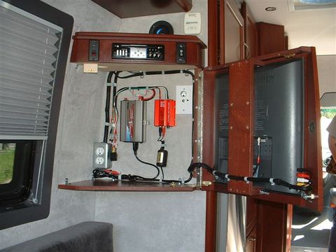

Ednj (Ednj)
Registered Member Username: Ednj
Post Number: 264 Registered: 3-2003 Posted From: 68.197.93.126
Rating: N/A Votes: 0 (Vote!) | | Posted on Tuesday, October 20, 2009 - 4:58 pm: | |

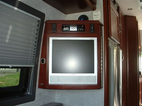

that is sooo cool!!! great idea so everyone can see it. |

Golliee that sure is purty. Ya wanna do mine?? I promise you won't go hungry. Gomer |

ED Nice job. Do you get any interference on the TV screen from the inverter? What is the orange thing beside the inverter? Bill |

Judging by the RCA jacks I would wager it's an amplifyer |

Thanks for the photo! |
