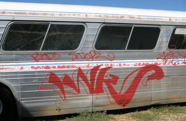

Went out to the coach today to prep it for moving from the storage lot to the pad next to the garage. This is what I found:
Yup, somebody's artwork, along with two new broken windows. PD took a vandalism report, but otherwise shrugged their shoulders. Can't do much w/ lot owner - written agreement is "park at your own risk". FWIW. . .

RJ, Sorry about your delema maybe some mineral spirits will remove that garbage, If not go to lowes,home depot or the local hardware store and get graffiti remover. I haven't found it to remove anything but that depending on the age of the artistic work. Good Luck Gomer |

Methyl ethyl ketone is the best I have found to remove dried enamel; GOOD lacquer thinner (from a body supply dealer, not HD or Lowe's) is second. Good luck. |

MEK methyl ethyl ketone. Available at paint/ hardware /Lowe's H.D. Excellent paint stipper. ...JJ |

Toxic stuff though, try not to breath the fumes. |

Absolutely. Wear a face respirator and rubber gloves when using a lot of that stuff. |

try oven off. It works on MC pin stripping. Mike |

"try oven off. It works on MC pin stripping. Mike" No, No, No,....The siding is aluminum, not stainless. Oven cleaner will eat it up. Len |

carb cleaner in a spary can and rags, removes it all, even after it has set up. ... where eye protection ... |

I have tried all of the above to remove graffiti, and all of them damage the stuff you don't want to! Then I stumbled across this "Graffiti Go" at Walmart. Most eco-friendly stuff doesn't work, but this does! We used it to remove graffiti on vinyl siding and it didn't affect the vinyl, and simply pressure washed off. www.ecosolveamericas.com good luck! Roger |

darn near anything that works will likely abrade the surface in the process of dissolving the grafitt0 pigments, and you may wish to amend that when your done.` ~ One thing I observed in the city , dealing with this often, remove it as soon as possible, before the next night, and when the young gafitti artists bring there buddies around to boast of there deed, you get to help them look like there full of crap to there the buds, and the problem self-remedies often. ~~ all markings are easier to remove in the first day before the paint or ink sets up & soaks in . ~~~Older stuff may also require steel wool or similar for abrasion on "porosus canvases" such as wood siding , concrete or brick. Got to love that Stainless Steel mci, IF ONLY you had used more of it then.~~~ >sure is funny watching this kind of nonsense on surveillance video in the course of "being responsible" for your own security. Seen a lot of crap & not much of was good crap like bus crap- >>IF ONLY not for those privacy laws, some of these moments in human stupidity would have made a fine & enlighting video for U-tube as to the motives for such behavior. >>>bus can't live with modern tech, nor live without<<< |

On real fresh graffiti, brake cleaner works if you catch it fresh enough, without much surface marking; use a soft rag and and catch the runoff as you flush with the brake cleaner aerosol. Something that should be on hand anyhow, next to the adhesive collection , as a prep cleaner before glueing. ... Always Protect yourself whole self well when using highly reactant toxins... |

98.7 % probability it was a "young she" that create this one , judging by the style and subject matter, most likely very early teens... the broken windows don't seem to be in keeping with the perpetrator though, must of been her younger sister getting bored with look-out duty. But that is just a rough guess based on a low quality picture... I was sure no-one want to know, so I though it appropriate to add this irrelevant info... ~the need to do 50 second parenting never ends~ |
