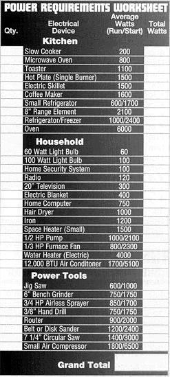

If you're doing load calculations this old outdated chart of estimates might help. YMMV. If someone has a better one, please post it.

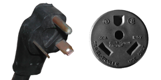

Here is an image of a NEMA TT-30; which is not to be confused with a NEMA 7- (277 VAC according to the random chart I found on the internet).
