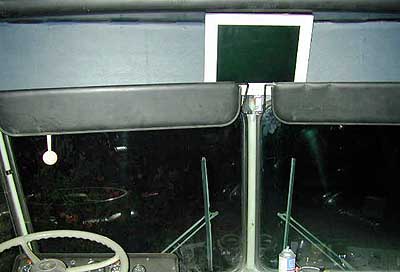

I picked up a flat 15" LCD monitor (VGA) for cheap from ebay, and mounted it right over my windshield center. http://www.heartmagic.com/00BusMonitor.JPG The adapter "box" Cory mentions is called simply a "VGA box", they retail for $99 but you can get one almost any day on ebay for half of that, often even less- check this one- http://cgi.ebay.com/ws/eBayISAPI.dll?ViewItem&item=1940643823 The box takes in 4 analog video signals and one VGA signal, and converts what ever input you select to VGA and sends it to the monitor. Really cool. So with my little setup, the monitor serves as television, DVD theater, Internet (motosat) or the backup camera, which ever I select on the VGA box. So far everything works perfectly but I still have to catch up with Scott to get the motosat working... Cheers Gary |
Gary Stadler (68.7.217.217)
Rating: N/A Votes: 0 (Vote!) | | Posted on Saturday, November 23, 2002 - 9:06 pm: | |
..I forgot to mention that both the monitor and the VGA box will operate straight from 12 volts DC Gary |
