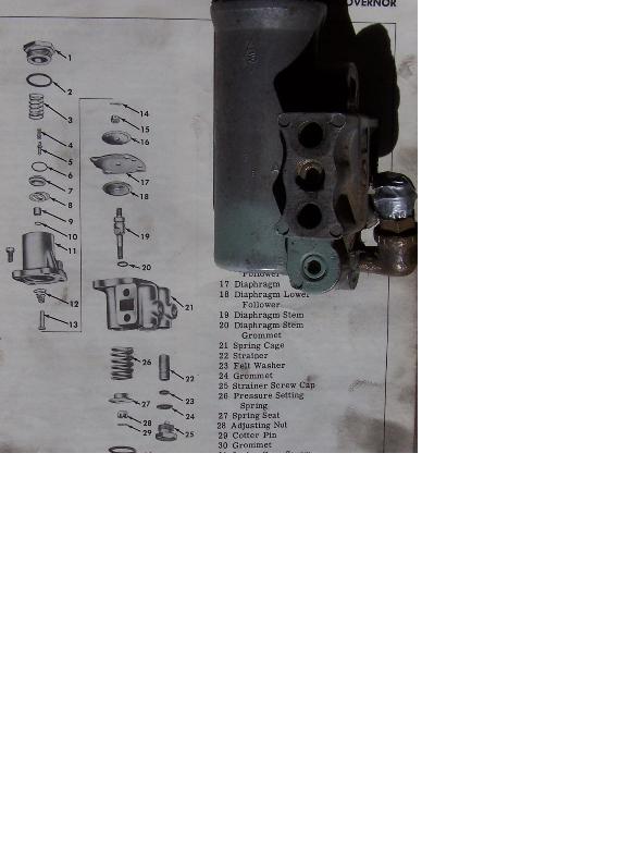

Hi All. I'm sorting out my air system (still) and was about to look at the govenor/unloading valve on the air compressor. Read Da Book first, then noticed the govenor looked different from the book, or I am not looking at it right. I beleive the govenor is bolted to the side of the compressor - there is no pic of the whole assembly I can find, but the drawings and such in the book are totally different than what I have. My part is is a simple single tube structure with two bolts holding it to the compressor, an air passage between them, and an air line that goes to the assembly on the firewall. It has a rubber cap on top, and a lock-nut and screw adjuster. Totally different then Da Book picture. Am I looking at the wrong thing, or are there different versions? Jim |

sounds like the govenor to me |

Here is a pic of the unit sitting on the pic in the book - not the same, or I am looking at something else? |

Jim, Yours is a D2 Bendix. The picture in the book looks a little different, but it could be a D2, what does it say it is? They are not expensive and there are rebuild kits available. The 280915 kit has high temp O rings and the 276121 kit has standard O rings. (Message edited by larryc on June 22, 2009) |

Some of the old style governors are still in service on some of the 04's and older, however they have been superseded by the newer tubular style , which is simpler and cheaper to service. |

My old type failed and I replaced it with the new type which looks about like the one in your photo. As I remember it cost less than $20 but that was a couple of years ago. The original 4104 gov was on the firewall, not the compressor and is where mine is located. It was easier to hook up there than to move it to the comp. There are actually two different looking gov shown in the book, neither of which looks remotely like the new ones. |

Problem solved. I drove up to the DD Dealer and bought a Bendix D-2. All he had was a remanufactured one - $14.19 - so I bought it. The one I had is basically identical and I was thrown off by the drawing in the book which I guess is an older version. Thanks for your help! Jim |
