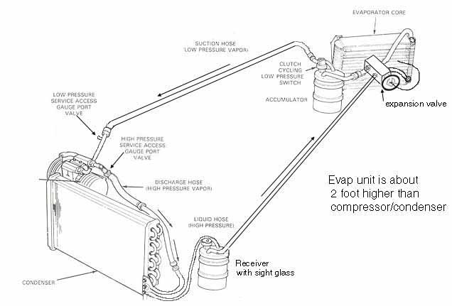

Mallie (65.38.24.92)
Rating: N/A Votes: 0 (Vote!) | | Posted on Sunday, November 17, 2002 - 4:25 pm: | |
In a domestic system AC system, A simple rise in the lines from the evaporator will form a trap that will keep the oil/condensed liquid from draining back during the off cycle. The same with the compressor if it is mounded high. Accumulators and receivers are not always used on a residential AC, tho are usually on heat pumps. The straight AC is where the problem can arise if one end is raised substantially above the other, with out use of traps. If the compressor height is great enough, oil can get stranded. The use of an Accumulator/Dryer on the low side will pretty well take care your system, tho I would still make a rise from the evaporator anyway. |
Rating: N/A Votes: 0 (Vote!) | | Posted on Sunday, November 17, 2002 - 5:17 pm: | |
My compressor will be just about centered with the condenser height, and the both of those about 2 foot below the evaporator level. So am I getting it right that you "want" the oil to run down to the compressor during the off cycle, but don't necessarily want liquid refrigerant to go there hence the accumulator? How's this: do I have it right? Any traps needed anywhere, and do I have all the parts in about the right places? http://www.heartmagic.com/00ac.diagram.jpg Last, I see the big suction return lines always have insulation around them on domestic units.... Necessary? Thanks! Gary |
