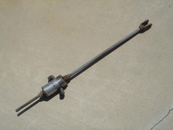

Bruce (Bgs4104)
Registered Member Username: Bgs4104
Post Number: 16 Registered: 10-2006 Posted From: 68.126.29.19
Rating: N/A Votes: 0 (Vote!) | | Posted on Saturday, June 06, 2009 - 9:54 am: | |
Here a photo of the sensing unit Bruce |
Jim Gibson (River_rat)
Registered Member Username: River_rat
Post Number: 78 Registered: 1-2009 Posted From: 75.95.96.192
Rating: N/A Votes: 0 (Vote!) | | Posted on Saturday, June 06, 2009 - 8:50 pm: | |
Bruce, Thats pretty cool -a picture is worth a thousand words! I am guessing that is a piese of the clutch linkage, and when the rod is compressed by pushing the clutch, that unit senses the pressure and starts air to a cylinder to "assist". Where in the system is that piece of linkage, and does it look to hard to change out? Thank You! Jim |

Bruce (Bgs4104)
Post Number: 17 Registered: 10-2006 Posted From: 64.166.166.40
Rating: N/A Votes: 0 (Vote!) | | Posted on Saturday, June 06, 2009 - 10:02 pm: | |
A bus buddy had this in made & stall on his 4106 in a shop where 395 & 58 cross west of Barstow Ca. The shop told him they maid the brain but I have seen them on other old bus too. I had a air assist Steering unit call Air-o-Matic on the brain but I never found out any thing on the manufacture, it looked just like this one but 100% bigger. The photo one replace the rod from the back bulk-head bellcank to the Clutch arm at the trans also needed is a air ram to push on the clutch rod Ie a front brake can will work. |

Post Number: 1497 Registered: 10-2003 Posted From: 71.58.110.9
Rating: N/A Votes: 0 (Vote!) | | Posted on Saturday, June 06, 2009 - 10:32 pm: | |
That piece installs from the shift rod tower to the clutch release arm on a GM. I think the name on my unit is Mardyne. Can't find any info, although I didn't look that hard as I don't need one. |
