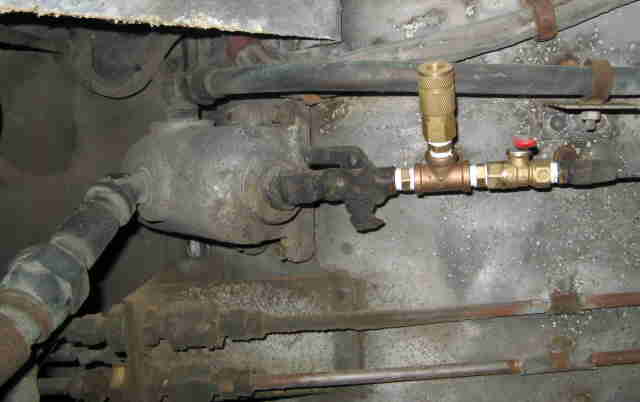

David - A "ping tank" is another term for the muffler plumbed into the bus air system immediately downstream of the compressor and ahead of the wet tank or wet tank/air dryer assembly. About 6"-8" in length, usually with a drain petcock on the bottom. Here's a pic of the one on my GM 4106, it's the grey cylindrical device to the left of the brass quick-disconnect fitting. This is mounted on the roof of the engine compartment, immediately inside the transmission access door on the curb side.

Dave, The ping tank (also called the "air compressor discharge muffler")is not the wet tank. It is the small tank at the end of the compressor's large discharge hose. It will be mounted high on the bulkhead on the right hand side of the engine compartment. There should be a drain valve in the bottom of it. A 1/4" pipe quick connect airline fitting, to attach your auxiliary compressor, can be installed in this valve. |

my 4106 came with an air pressure regulator between the main air tanks and the aux -- it will not pass air pressure from the main to the aux until the pressure rises to above its setting (about 65psi) As I understood it this was to get pressure in the main system first and quicker. There is a check valve between the aux and main that does allow air to pass between the AUX and MAIN anytime the AUX pressure is higher as mentioned above. I fill my bus from the AUX air tank (its 35' closer to my home air compressor than the rear of the bus -- plus the rear of my bus bumper is about 5-6' off the ground -- engine air fitting would need a laddar or pull the bus off my "railroad tressel" parking spot -- only way I could get a leval parking spot with nothing but hills around). |
Post Number: 1023 Registered: 11-2005 Posted From: 209.142.172.129
Rating: N/A Votes: 0 (Vote!) | | Posted on Tuesday, October 20, 2009 - 11:52 pm: | |
I also charge my system from the aux tank, it is easier to reach and works just fine. I tried it once just down stream from the muffler and it made the check valve at the muffler do a noisy dance, haven't done it since. It appears the 4104 and 4106 have about the same air system, since they are close siblings this makes sense. I like the system because it is pretty simple as built but, as was posted, many things get changed over the years. For example, my ICC valve is hooked up in reverse. Needless to say I have locked it out of the system!! |
